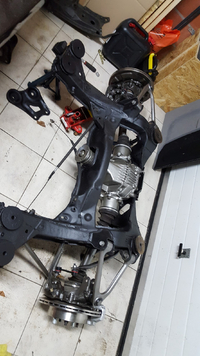

First up, breaking down the blue one.

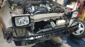

Then the two tone. Removing the bad engine. It seemed my engine crane was too short so i HAD to remove bumper and everything just to get the engine out.

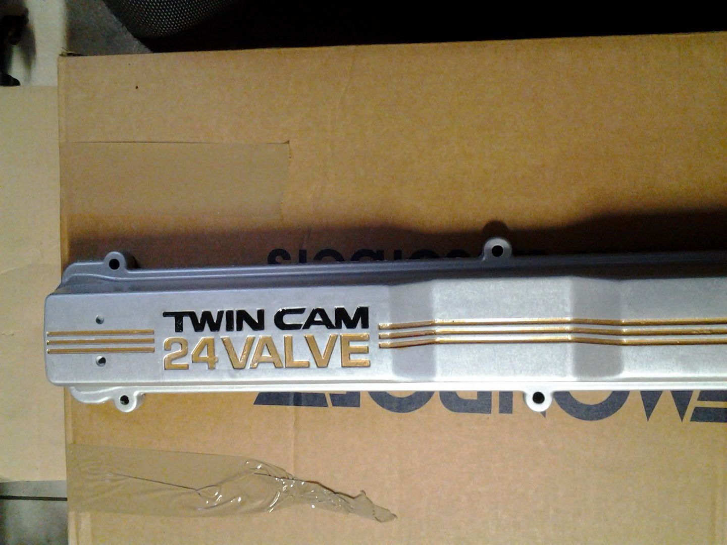

Cleaning and preparing the new engine and gearbox

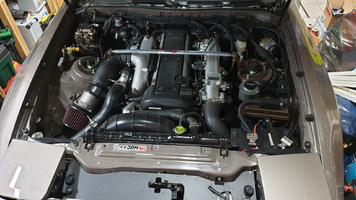

But then, getting the engine in ALONE is not easy!! i had to level the engine, make sure it was in both mounts and the gearbox kept getting stuck below, lower it at the same time. So this took a few hours but eventualy ended up fine
All set, started right up. But the steering rack was leaking and needed replacing (luckely i had a spare laying arround) Would have been much easier if i had know before i put the engine in but after some sweat and grease i got the job done. second problem was the slave cilinder leaking. I opened it up, cleaned everything and some slight sanding with P1200. put it back together and good as new

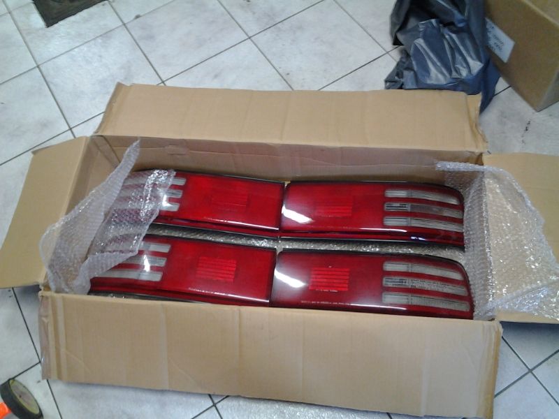

Removing the EU tails, and replacing with my USDM from the blue one (a little later with JDM's i bought on ebay)

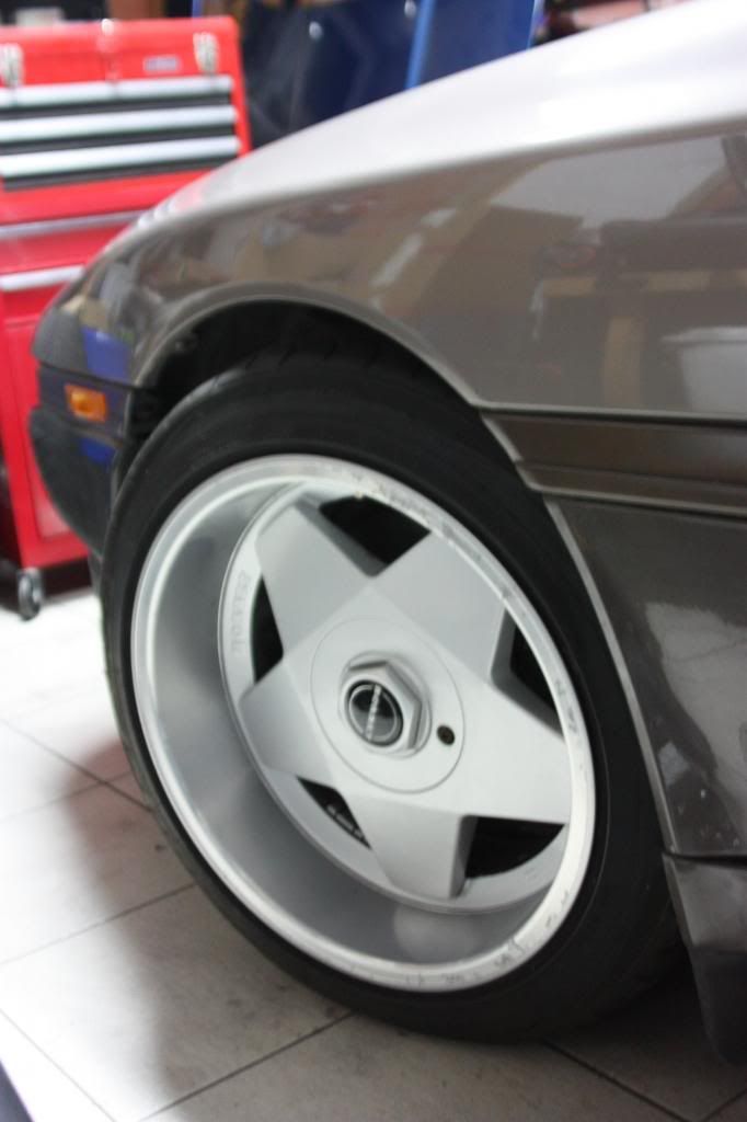

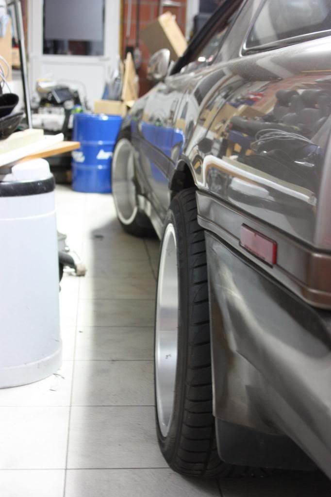

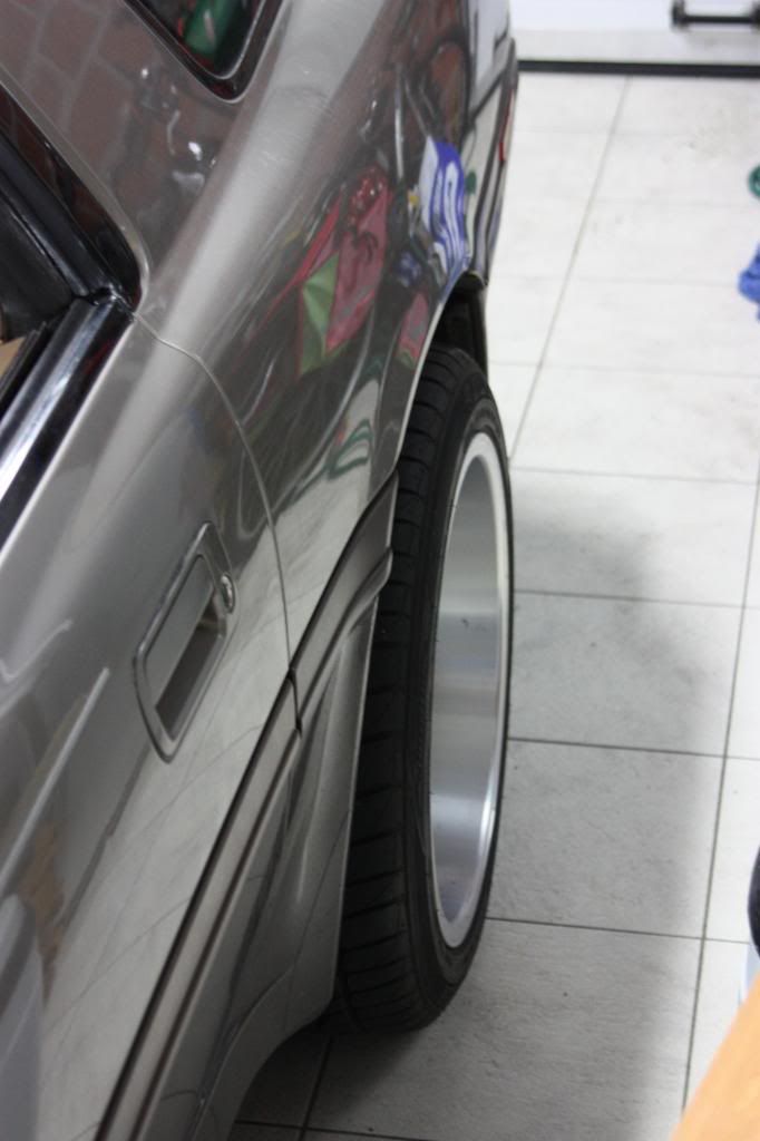

These are the 17" Azev rims ive got laying around

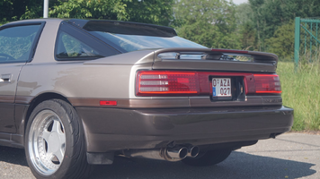

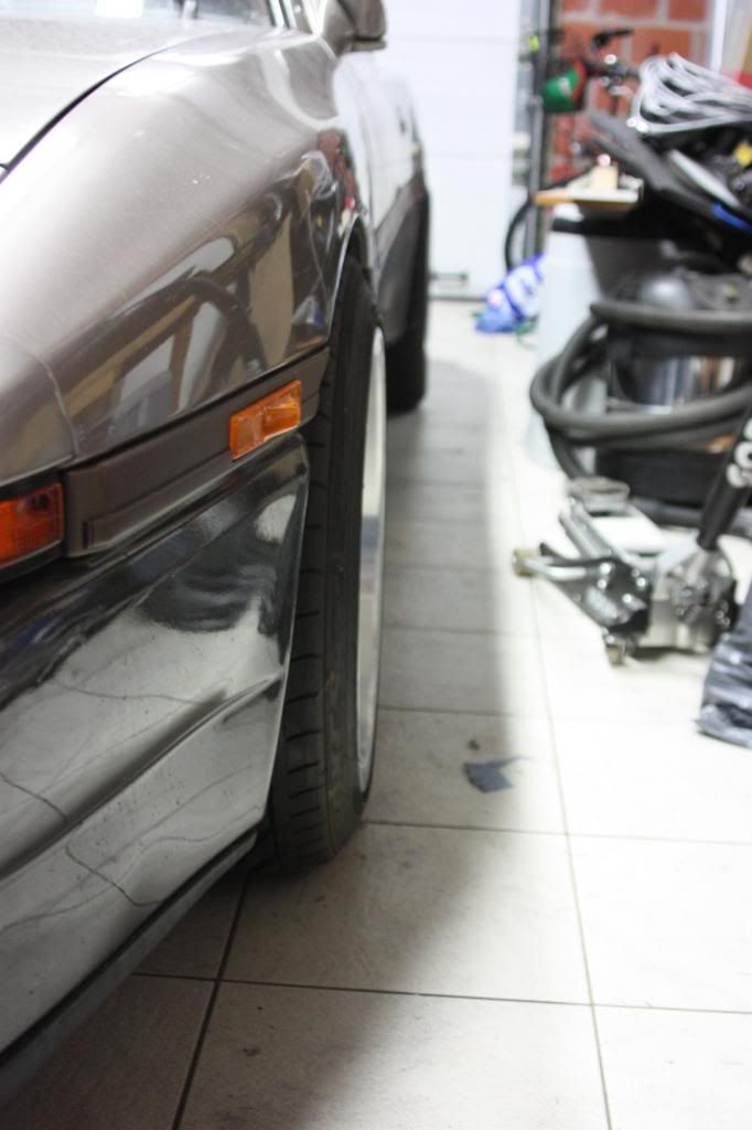

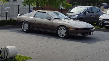

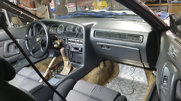

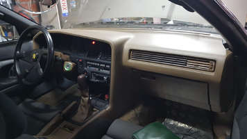

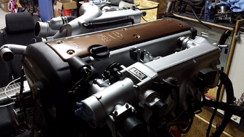

I changed the suspension with Koni+Apex lowering springs. This is how the car is right now
