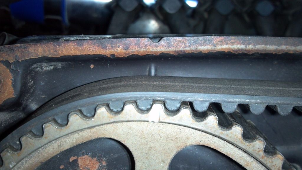

Update : The toyota dealership got it running, the timing gears were set wrong. Apparently the guy who changed the BHG put em in wrong.

The timing :
I was also told to check that the cam lobe was on its upward swing when at TDC, and it is. I have not yet gotten a timing light, but plan to buy one Friday when I get my paycheck.

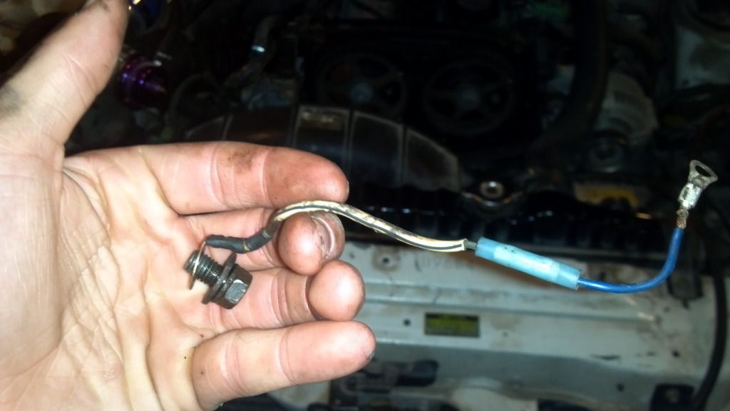

I had a box of things that I got from my friend's house when I moved the car, and when I was going through it, I found this wire :
I have been told that this might be a coilpack-to-valve cover ground, and was told to look on the drivers side of the coilpacks for a ground wire, but had no luck finding one. If this is correct, where would I run the wire from, and where would I ground it to? I was thinking that maybe this is where the ground should end, and have checked the bolt, and it seems to fit :

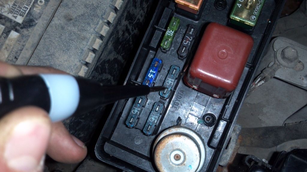

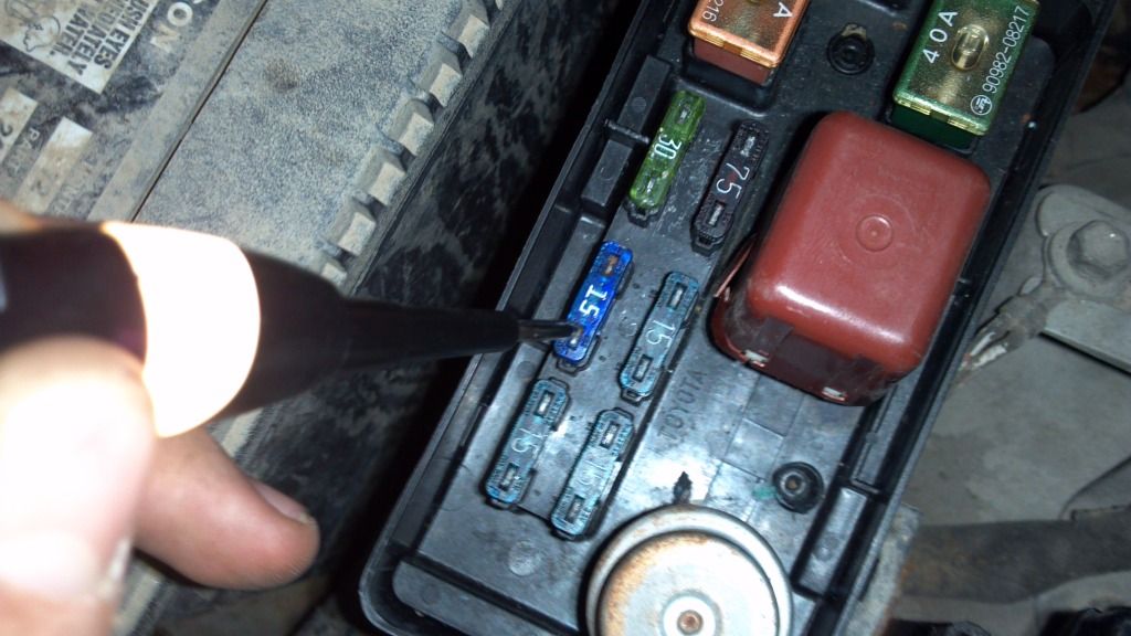

I have also found that some of my fuses near the battery are not getting power. I was testing them with a test light, and the row of fuses closest to the battery all light up fine, but the fuses (including what I believe is the EFI fuse) further from the battery do not light up. The fuses do not appear to be blown, though.
What would be my next move to make from here? I think I need to figure out why I'm not getting power to those fuses, although I'm not sure what could be preventing these but not the ones next to them.
Edit : Ignore the fuse part of that, i was checking the wrong fuses, my bad

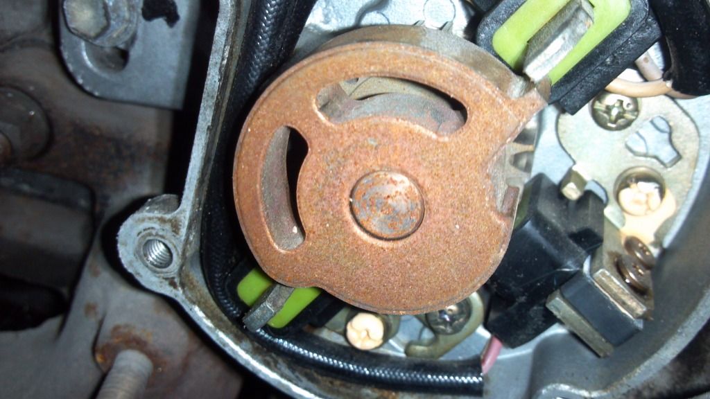

So I decided that I would take it home and finish it up myself. I have had it at my house for about a week now, and have bypassed the security (by grounding the blue/orange wire leading to the Theft Deterrent Computer) and put the belts back on, and now I'm kind of at a stand still. It will crank, I have spark (shocked myself while I was checking it haha) and I have jumped the FP and B+ on the diagnostic block and my fuel pump will turn on, but it won't turn over and start. I have also jumped the T1 and E1 diagnostic spots, and got a Code 11.

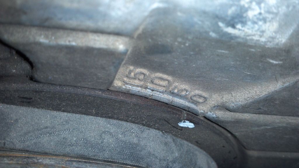

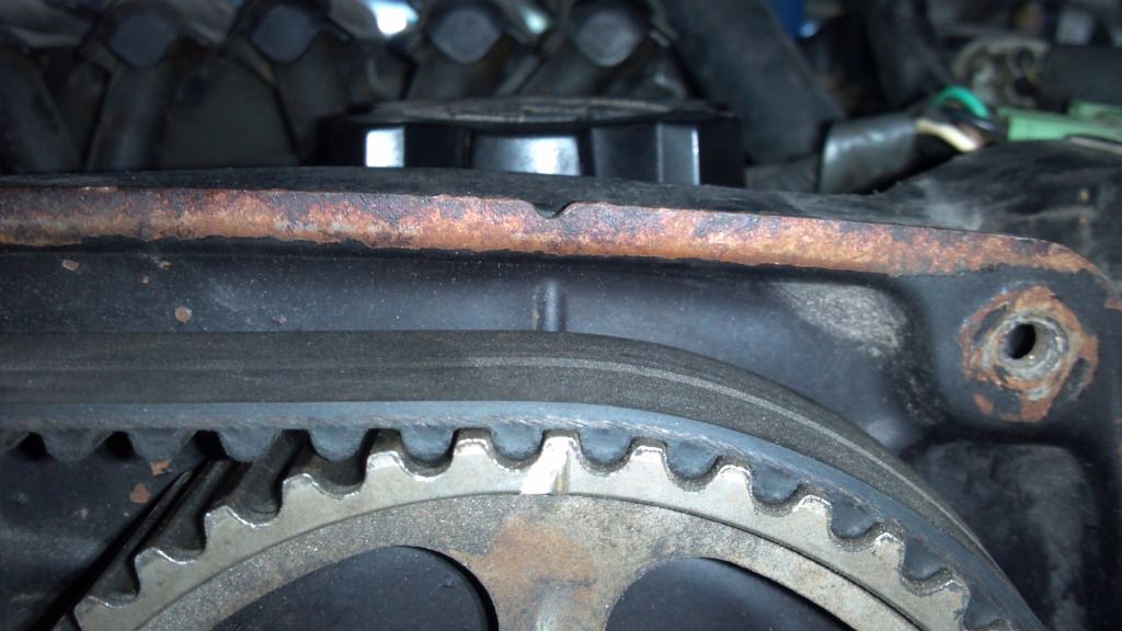

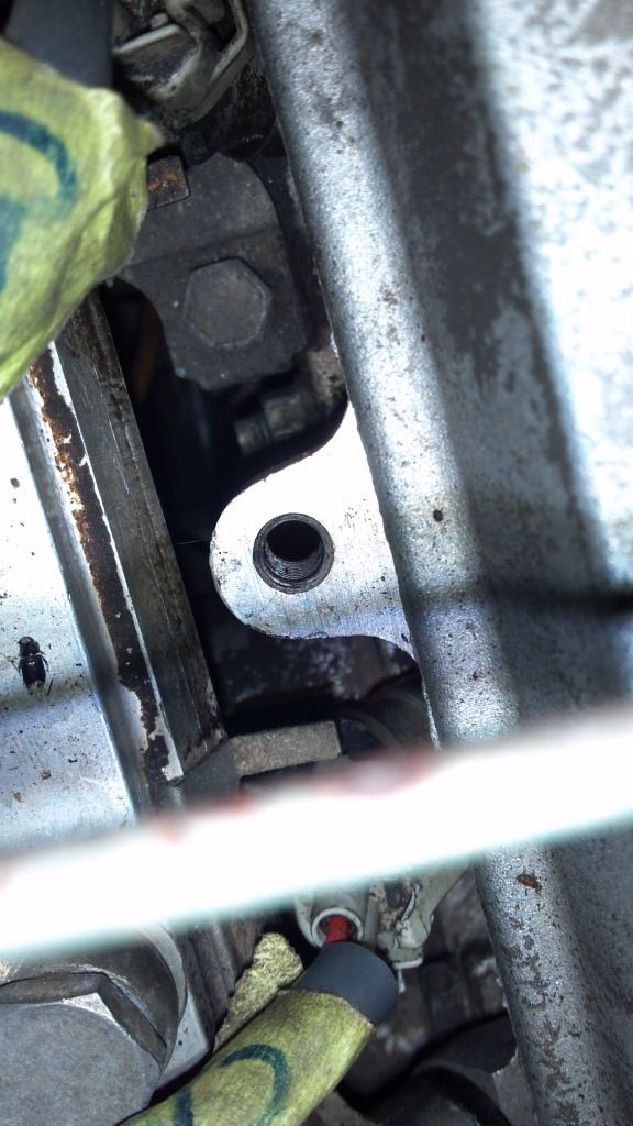

The timing :
