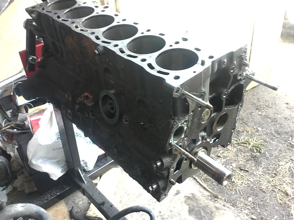

I found this picture from back when I was tearing down the block, before its visit to the machine shop:
I can see the oil galley plug ont he front of the block there (Prime suspect) and was told that there would be another one on the side of the block, directly fore of the oil feed. Judging from the oil flow diagram, I think that there are 3 lines drilled into/through the block for oil passage, one front to rear, and feeds the turbo, oil squirters and main bearings. One in from the side to under the oil feed to the cylinder head feed (directly down from the small hole at the front of the head gasket surface) and of course the one downwards through the block to feed the cylinder head. If it's the plug on the side, I have a shot at being able to fix this in the car without too much disassembly.
If of course it's the main plug at the front of the block... Well, it'll need dealing with.
