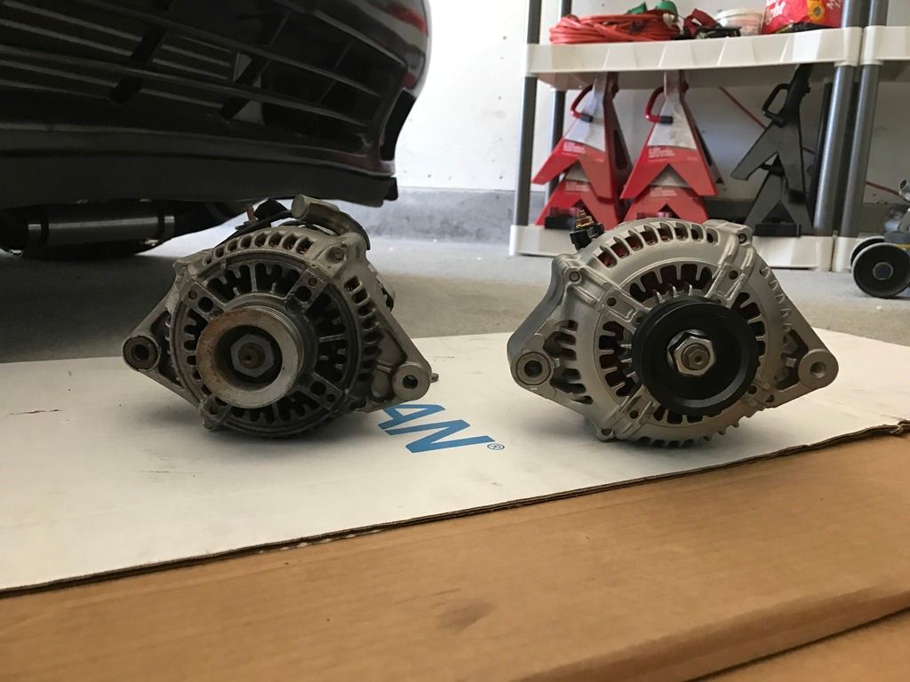

I'm in the process of installing my new 200A "Big Body" Alternator. Not sure if this is an MR2 casing or what, but it is definitely bigger than the 130A alternator that I am replacing. Weighs almost double the amount as well.

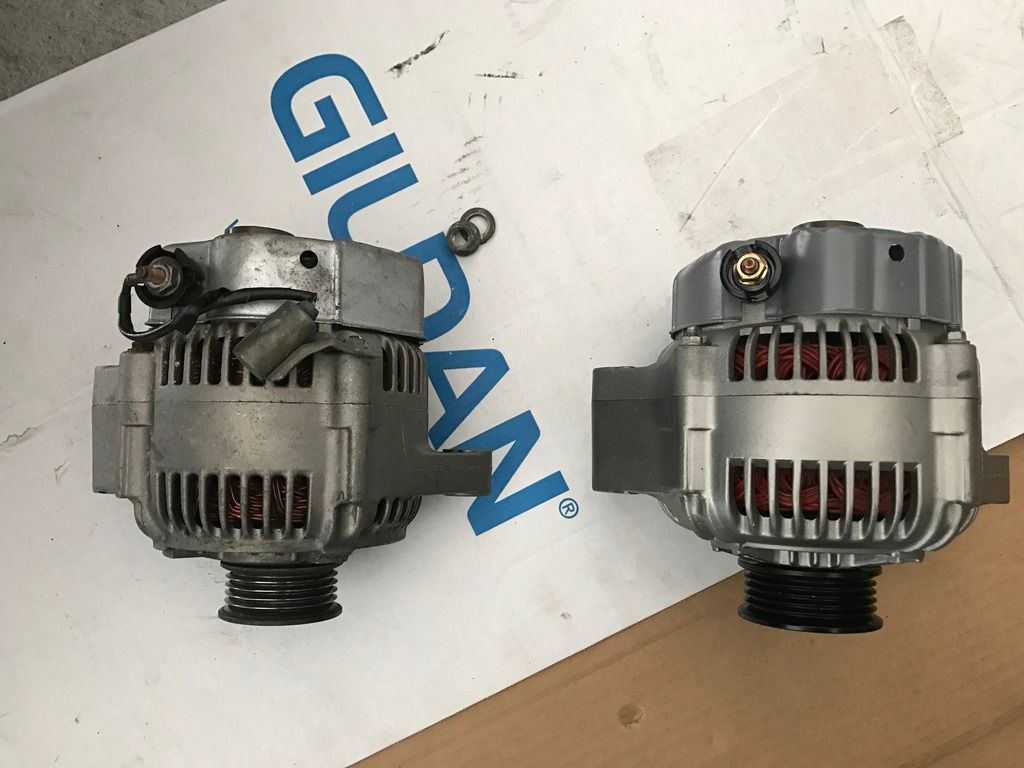

You can see just how much larger the windings are on the 200A.

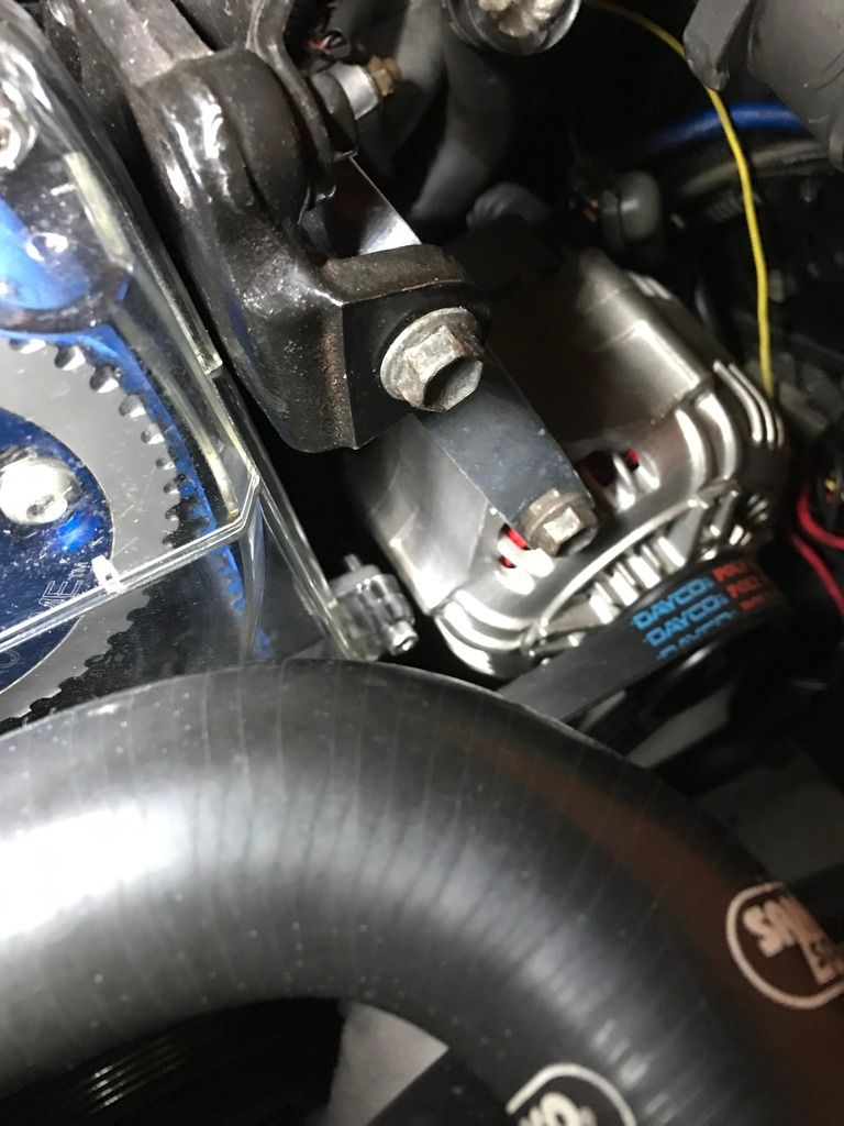

We'll see if this takes care of my voltage drop issue when the engine gets hot and the efans kick on. I'm also going to run a dedicated ground from the alternator casing to the negative battery terminal. I'm wondering if this was one of my problems before since the casings are painted and the aluminum relocation brackets may not be providing a good enough contact point.
