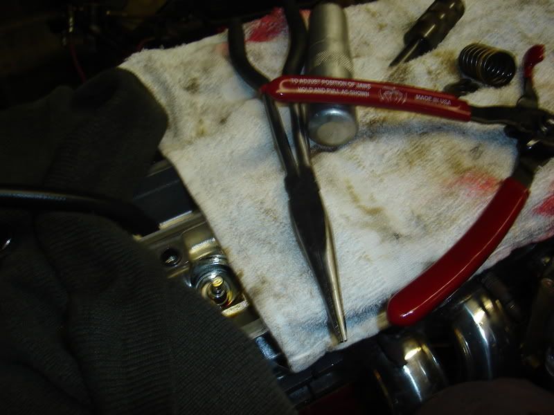

i used this spark plug boot remover(red handle plier looking thing) to pull the seal's off the guide.it take's about a second each one and no accidental damage to a guide.
