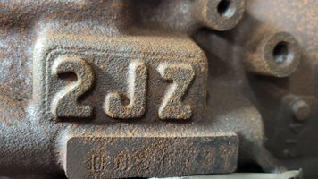

Yeah, that's absolutely not worth it, if that calculator is right. I've actually got a 2JZ-GE vvti that was originally intended for this car. My 87 car though, is near perfect and I just want to drive it, so I picked up a good GE motor and W-58 to go back in it. I have a 90 Turbo 5sp also, and an 86.5 that will now receive the 2JZ. Plenty of other opportunity for making power, so I'm not too worried about the 87. I just thought if there were a few simple things I could do to get a few more HPs out of it, why not?
