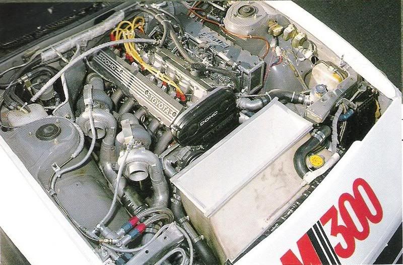

HKS did this back in the 80's with their 7m mk3 dragcar and I did this very project like 4 years ago!:naughty:
That car made over 800 hp w/ the 7m head!!! I thought of doing this myself by cryo treating the stock 5m rods and 7m n/a pistons.
