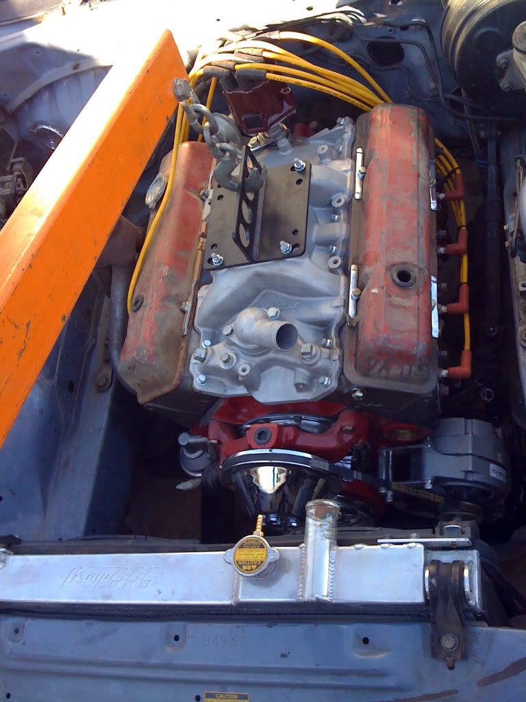

Spent the day in the garage putting together all the small things for my V8 Supra Project. Almost ready to fire it back up. Going to put in some 3.72 gears from a '89 + LSD diff. The open 4.30's won't do, to low. Engine is a flat top 350 Chevy with a roller .510 Lift Camshaft, Vortec Heads with LT4 Springs and Roller Rockers, Edelbrock Performer RPM intake and a 750 Edelbrock Carb. Tranny is a 700R4 with a shift kit, 3-4 downshift eliminator, 2500 RPM Stall, Tranny cooler with fan. Cooling is through a corvette short style water pump with an all aluminum Radiator and a huge electric fan. Need to wire up and bolt down an auxilary tachometer, swap diffs, fab up an alternator adjustment bracket, bolt up the tranny, tighten the trans cooler lines, install the starter, hook up the shift selector bracket on the tranny and adjust, bolt on the driveshaft and fuel lines.

I'm guessing around 400 HP / 400 lbs torque. Plan to later add a 125hp shot of N20. As it sits (no NOS), it'll run mid / low 12's (if it'll hook). Had this engine tranny combo in a Vette and it ran high 12's with a 2.73 axle ratio.

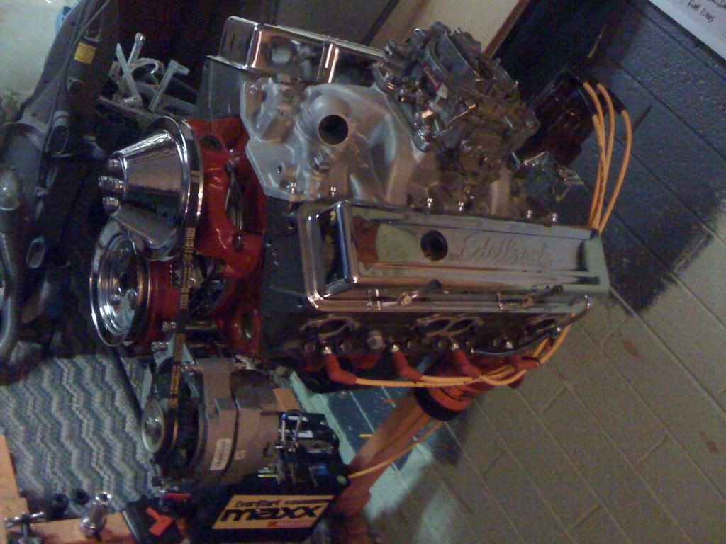

Here's a few more pics of my project. Just got it done today. Need to go back over it, wet sand and use the filler where need be. But at least it's up and running good! This thing is fast as hell! Got on it a few times while driving. Put it in 1st gear (@20mph at 3,000rpm) and hammered the throttle. Spun the tires immediately and I shifted to 2nd, working the throttle to control the tire spin. Traction is limited under 30 mph. Wicked fast. Sure I'll be running mid 12's.

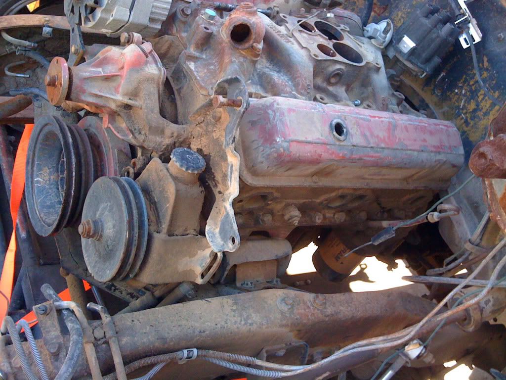

I still wish I finished my swap from awhile back :( I think about doing another one everyday
