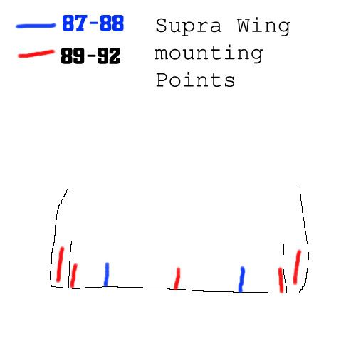

For clarification

^^^^Nice Art there lamo!!!!
You will need all side interior plastic and interior decklid platic off!!!
No its not that hard and requires no template. All you need is a good eye, a pencil, and a drill. Line up the spoiler on the decklid the way it should be. Once set circle the bolts coming from the spoiler with a pencil. Drill your holes and your set. You will need some screws for the sides of decklid spoiler. As far as side pieces they have plugs that hold them on. You can get them at toyota or Napa sells similar. I saved a few bucks at Napa. Set side pieces how you want mark plug and drill. Snap in new plugs (two per sidepiece) and your set. As far as the pre 89 spoiler goes, the 89+ spoiler does a good job of covering up your decklid. The best way is body work, but a quick solution to avoiding body work might be some of those plastic flat top plugs to fill the holes. I would glue them in so no leaky and then use touch up paint to paint them the same color as your car. I bet you couldn't even tell you did it unless you get up close and know where to look. Thats my two cents!!!
