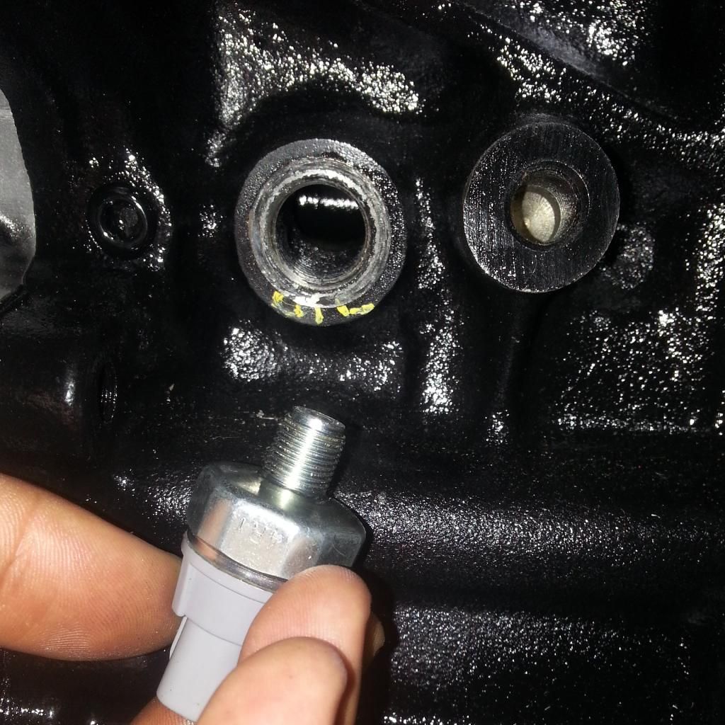

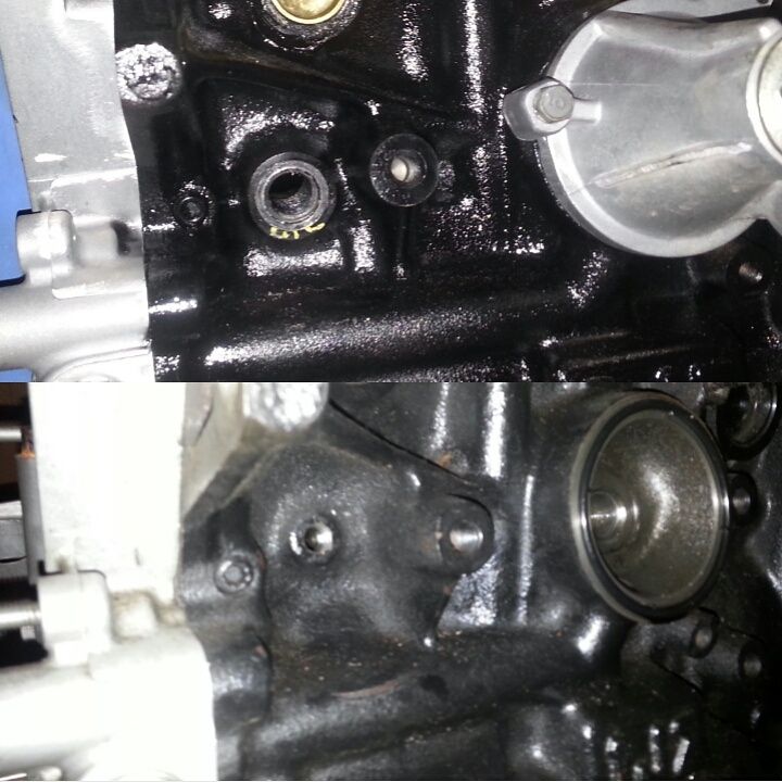

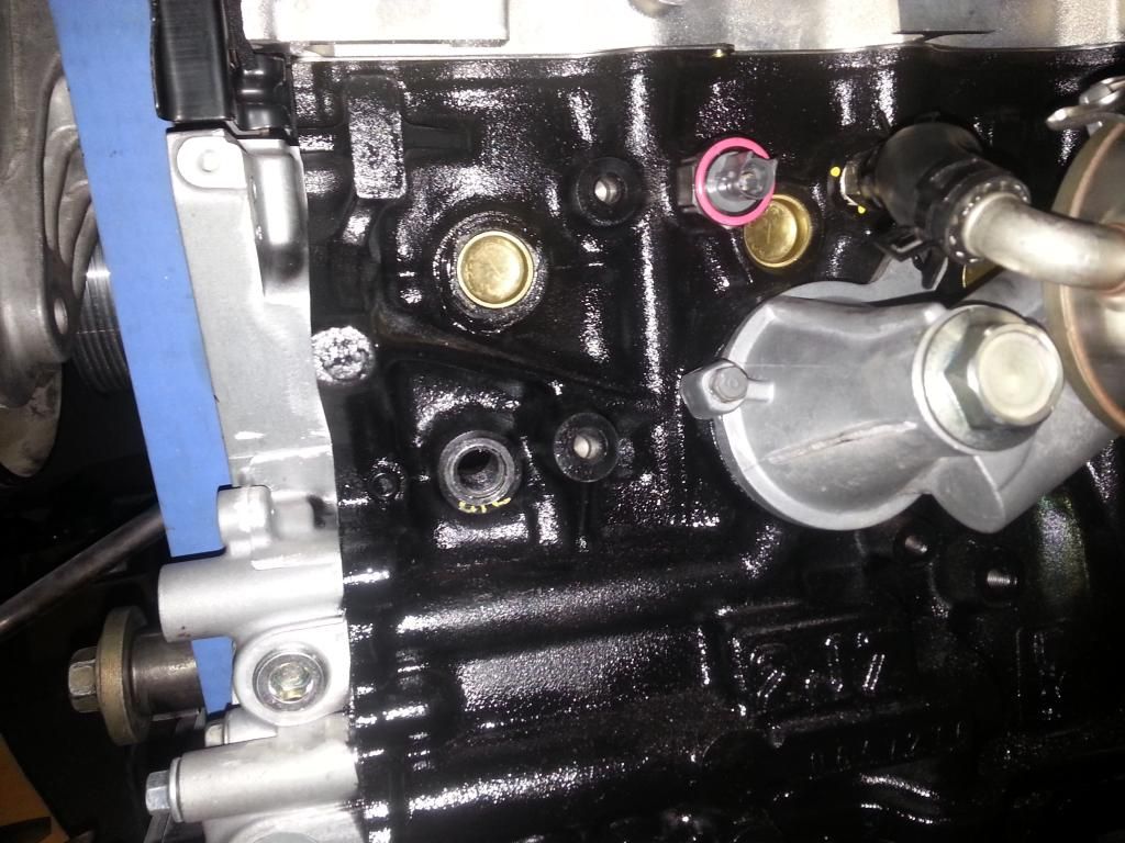

pictures speak for themselves. Basically I built a 2jz and go to put a oil ppressure sender on and the hole it the block is way to big for the stock sender. Can anyone shed some light on this? What 2j block do I have or has it been tampered with?

The issue is that the hole is much larger then stock. I need it to accept the stock sensor. It is not in a min supra it is in a BRZ.

That looks like my VVTI block, the oil pressure sender attaches to the end of the bolt that mounts the oil cooler/filer.
The hole your pointing to connects an oil line up to the VVTI unit on the head
