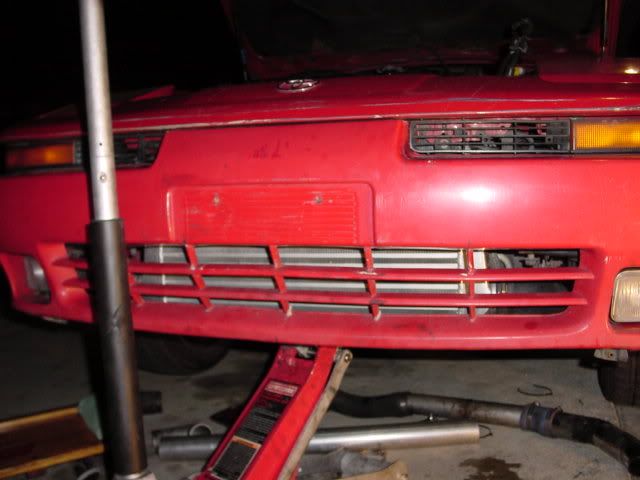

Test Fit
You will notice that the intercooler is much easier to fit if you have it on a jack, rather then trying to hold it up yourself. I've done this install many times, but this was the first time with the nice jack, so I could just hold up the intercooler where I wanted it and go from there.

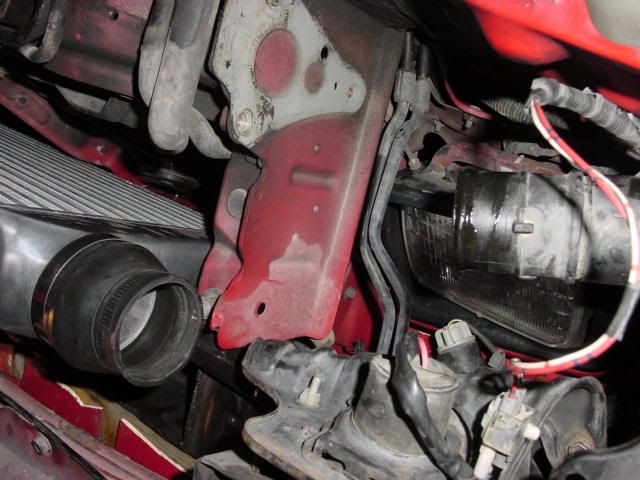

You will notice that there is a lip on the back of the bumper support. It is soft and easy to bend. If you bang on it, cut it off, or bend it up, you will find a little more breathing room to mount. You can also bend back the center support (under hood support) to get more clearance. Once you have this clearance the intercooler will go all the way up.
Note : 91-92 owners will find a massive power steering cooler up where the intercooler wants to go. This creates 2 problems. First, you can't get the intercooler as high as you want it. You want it as high as possible to prevent it from hitting things in the road, curbs, and overall looks. Some like to mount it a little lower to get more air to it. Second, the power steering cooler will cover the top bracket holes on the IC, preventing you from making top brackets.
The solution is to either remove the power steering coooler, re-locate with a smaller cooler, or unbolt the 10mm bolt holding it in place and jam it up higher so the IC can fit. I did not want to remove this one, so I moved it up. It is not bolted down, but it is stuck between the intercooler and bumper, so it is not going anywhere.
Once the intercooler is where it should be, we can continue.

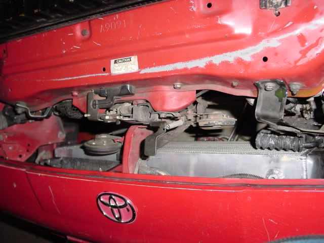

Oil Cooler / Overflow / Driver Side
Here you can see the IC resting in place. The lip on my bumper support is gone, so I could easily slide it up and i did not have to modify my center support. The oil cooler is still connected to the stock lines and is resting behind the new IC. The 7M overflow is removed.
The stock bracket was bent upward some for clearance and 1JZ overflow installed. It has more room for an intercooler and was straight forward.

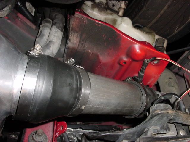

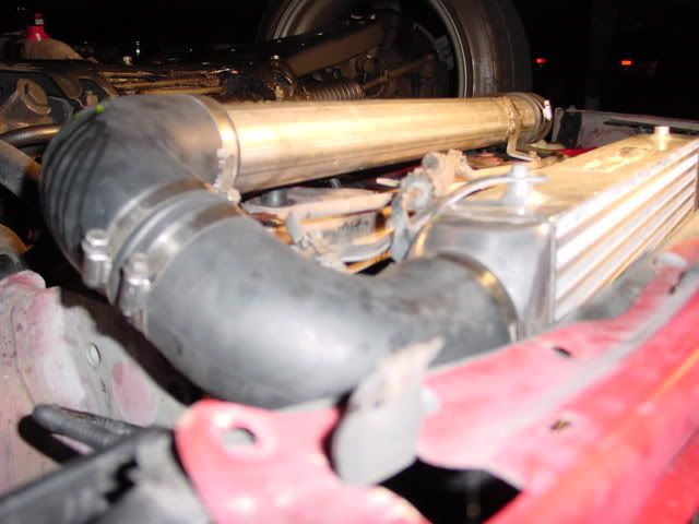

Here is the first look underneath. There are a few issues here. We want the driver side of the IC to make a U turn and go back to the turbo. However, we want the pipe to hug the body so that it is not obviously lower then the car and prevent it from hitting the ground. As you can see the AC line is in the way, and the oil cooler is in the way. On top of that, the oil cooler hard lines are in the way of putting the pipe to the body. Finally, the tow hook should be removed here. It makes things much easier and you have room to play with. If you are not comfortable with this, you can cut a piece off or bend it to the side if needed, when you get to that point. I can tell you now that removing it is going to save you lots of time. 3 17mm bolts and it's off.
For the A/C, you can remove the black bracket and bend the line up slightly. If you don't have A/C, then you are set. The oil cooler causes problems throughout this installation. I would suggest removing the entire system, pipes and all, and install it on the passenger side. This removes the metal pipes AND allows you to actually go behind the IC with the piping, completely hiding it from public view. This is what I desired to do, but time was at a minimum.
Here is the end result. Since I could not go behind the intercooler as planned, I had to go under the body. Originally a steel u-bend was to be used as a 180 degree, but they did not have short radius. You need a short radius bend. The steel U bend was $30, plus $10 for the 3" to 2.5" coupler. However, 2 90 rubber elbows were only $20 total. So I used rubber instead this time around. This also saved weight as the steel is very heavy. I had to weld a bracket on the steel long pipe for safety. In the event that the hose was to ever blow off, the pipe will not fall off. 1 on each side would be better.
You need a straight long pipe to go back to the turbo. I would suggest aluminum, if you can find it. It is much much lighter. I would still suggest making the bracket. I will update the top page with lengths later on.

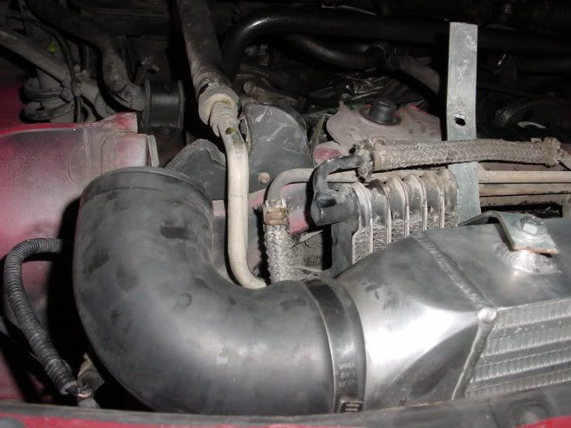

This is how it starts once the intercooler is in place. As you can see this is the easy part. All you need is a simple pipe to go from the outlet to the fender pipe. If you position the fender pipe right and the IC right, they are pointing right at each other. You just need 45 degrees and a small straight section. You can use a 45 degree coupler to the fender pipe with straight pipe, or weld a 45 degree end on your pipe. I also found something interesting, one of the 1JZ stock plastic pipes fit perfectly here, the one on the turbo side of the 1JZ. Something to consider if you have any friends with one laying around. Anyways, I found that with some wiggling and some creating positioning of the 3" coupler, a simple straight piece worked. In the picture the passenger side tow hook is removed, but i found that it did not obstruct anything and I put it back on. The passenger side tow hook must be removed in a 1JZ installation though.
Air box note: For those that like to go up through the airbox, it is pretty simple. You must come out of the IC about 3 inches straight. Actually having a 3" or 4" straigiht aluminum pipe welded directly to the intercooler would be ideal. From there its just a 90 degree shot straight up to the airbox hole and a 45 degree bend to go through it. For 2.5" piping there is plenty of room to avoid the headlight.

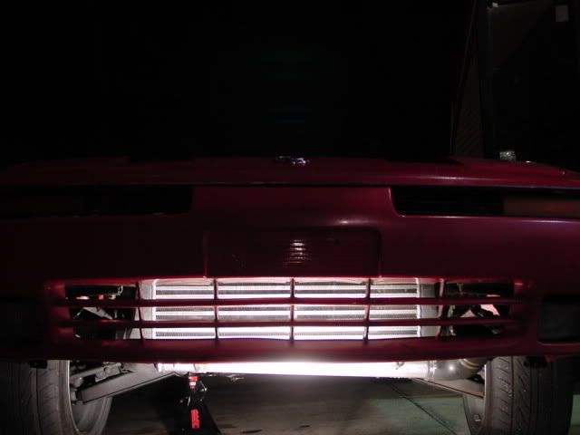

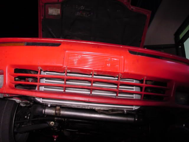

Here is the final product:
