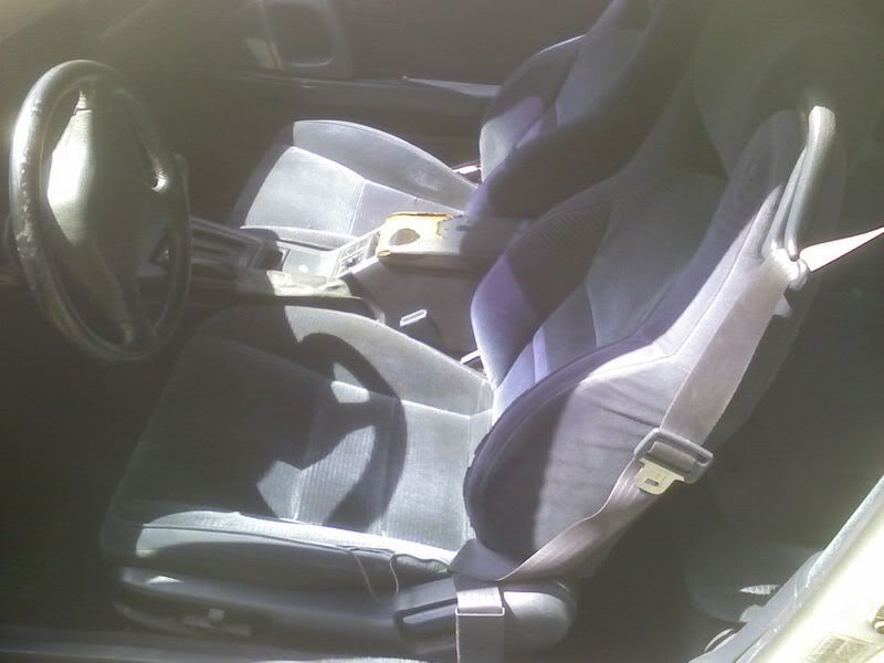

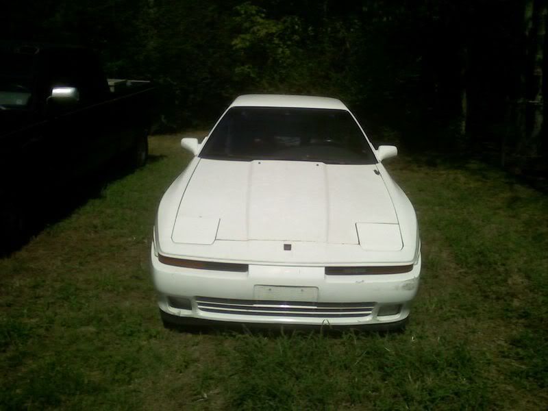

Oh and here are a couple pics of the car. Paid $475 for the shell just need to get her running. Once i get an engine work on making her beautiful will begin
