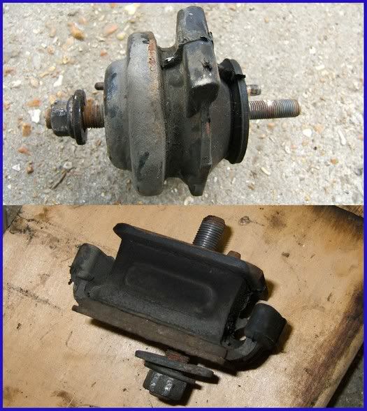

You need the Round style motor mounts to be able to use the stock 1jz motor mount brackets. The offset ones look like theyre the pre89/square style which are the wrong ones.
Heres a picture of the two that I found on google to show that the stud is offset on square style and not on the round.

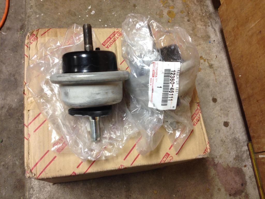

You can use the round style 89+ motor mounts from our car. Or you can get the 97-98 MKIV TT motor mounts grind off one little tab and theyll fit as well. The MKIV Motor mounts use Toyota Part Number - 12360-46111 You obviously want to order two if you go the MKIV mount route.
Pic of what the MKIV mounts look like.

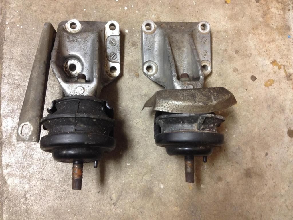

Are those 1jz motor mount brackets from a JZA70, or Supra?
This is what my JZA70 motor mount brackets looked like. Looks like you may have the wrong ones.
