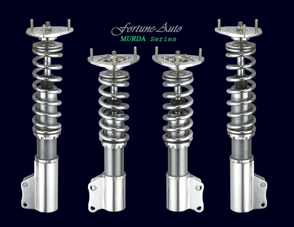

I was shopping around for some coilovers for my car and found these no name brand coilovers. Now Im the type of person that always pays little bit more and buys the name brand parts for my car because i like the little extra security in knowing that i have a quality part. Now the only reason i was considering these is because the couple people i have talked to with these coilovers loved them. Here is the post from the person that is selling these coilovers so let me know what you think of these by looking at the info posted. Thanks!
Vanden Plas;4241212 said:
GROUP BUY
Fortune Auto 50mm beefy ass coilovers
I have been selling these to a few forum members and close friends in the past few months. So far I have ordered 3 loads (over 30 coilovers).
I have 2 sets on our track car that have performed flawlessly and we have installed them on the s15's. They drive like a freakin Cadillac that low on full soft. I am so impressed with these things I decided to become the exclusive US distributor.
Coilover Specs
  • These are comparable to Tein Flex's but at almost half the price.
  • They include a 1 year Manufacturer's Warranty
  • 40-way adjustable dampers
  • They incorporate a 50mm piston (way beyond the industry standard of 44-47mm that Tien, JIC & Cusco uses)
  • Fully anodized (unlike Tein and Cusco that are partially painted)
  • Anodized aluminum camber plates on fronts
  • Custom valving and spring rates for an additional $100
  • Custom chrome finish on our "MURDA" Series for an additional $100
  • Height adjustment independent of preload so you can DUMP your shit while retaining full suspension travel
Coilovers come complete with spanner tools, adjustment knobs and brake line mounts on some applications

They're probably the same as D2/Ksport and very similar to the rest of the cheap stuff that's on the market right now.
So spring rates will not be properly selected or even have any rational thought behind them. And if they can't pick spring rates, then you know that valving is going to be off as well.
I would not recommend them. Unless you just want something that will let you slam the car and make it look cool but not handle/ride well. But that's not saying that most of the "name brand" JDM crap isn't the same thing.
