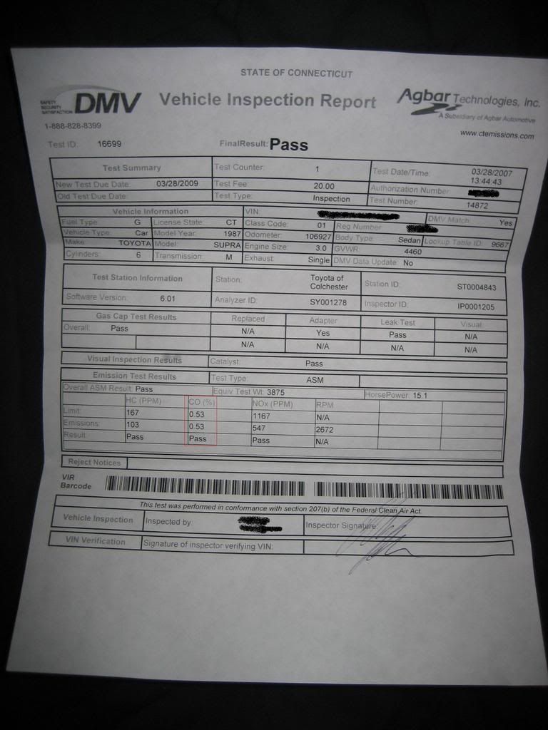

woot! take that CT emissions!!
catch2nd
80's toyota lover
53
Oldest fair in CT
550cc injectors, maftpro with speed density runing an UNADJUSTED 18psi street tune!
I was excited for it to pass, and it was pretty cool as every tech in the shop and even customers from out in the parking lot watched as the car was on the rollers
Comment, discuss
-Dustin

My NA always just barely passes, except this time it failed. Here are my numbers in CT:
HC
Limit: 167
Actual: 18
CO
Limit: 0.53
Actual 0.02
NOx
Limit: 1167
Actual 1453
Everything is perfect, except the NOx levels. I think I might need a new cat, the car is starting to smell like the cat isn't doing it's job anymore. I have a small leak in the pipe that goes into the cat also. What do you guys think? The car has been idling great, I get 22 mpg highway even.

And how exactly do the numbers show my engine isn't running right.... high co levels simply show a "rich" condition as the combustion resulted in too little oxygen and too much carbon to make co2... correct? As already stated, this test was on a rough 18psi street tune on a daily driven car, so if running it a little rich is safe, even more so with the high levels of ethanol in the gas here, then so be it

My numbers here in CT are:
HC 66
CO .17
NOx 161
I did that on 4/27/07 on bone stock exhaust, cat everything and a new head gasket.
I'm interested in your GVWR, mine says 3665 yours says 4460. Did you have a couple bodies in the hatch? My Equiv Test Wt is 3875 just like yours so I don't get it.
