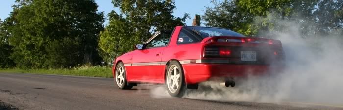

Ha ha ha... if your Supra does this
you may have a BHG :biglaugh:

(grimsta) It used to look like that out of the exhaust. But now I got the turbo on. And all is well. At least kinda.... until I find out where all the vaccum lines go... that some retard replaced with caps go:3d_frown:. Some people need to just leave crap alone!!!
