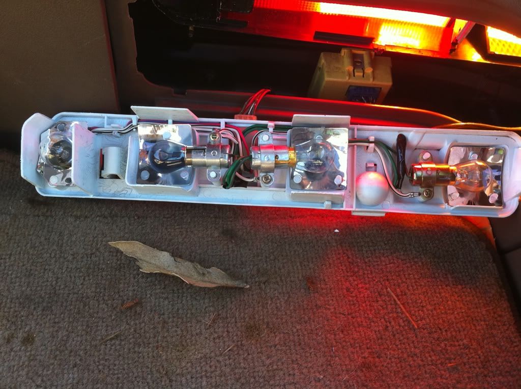

In my left rear lights those two bulbs are always going out, I'm probably replacing one of those every month! When it rains it's every other week lol help?
well this sounds familiar to me hahahh. its because of the water. either get a new tail light seal or put some of that bathtub caulking (the clear stuff from home depot). but im not too sure about the caulking cus i've never done it. but im sure someone's gonna call me a noob for even suggesting it lol.
So are the bulbs you replace actually electronically bad, or making poor contact?
The reason I ask is because it could be the water, or worn/corroded socket.
