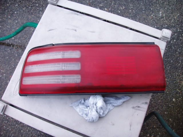

Will I be able to tint these tail lights?
mattgo
Oct 15, 2006
211
Anacortes, WA
my 89+ tail lights got some paint stripper damage on them but I sanded it to be really smooth, but you can still see where the paint stripper did the damage. Will the white parts show when I tint them?
thanks
same pic, but with flash:
BorHor
2JZ-GZE
Jan 10, 2006
6,181
San Jose, CA
Yeah I think you will still be able to see it = / Try and find a new light. It isn't to much when it is a single piece and not a set.

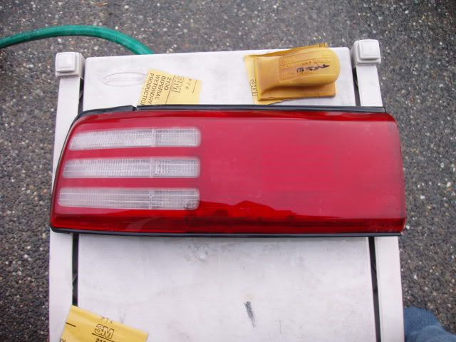

hmmm......thanks guys, you were all helpful. So just clear coat after wet sanding them, then apply the tint?
Nate: How much do you want for them?
mattgo
Oct 15, 2006
211
Anacortes, WA
well I wet sanded it with 800 and 1000 grit today, a lot of the white crap came off
and I'm guessing this is what it'll look like after the clear coat of paint
you can still see some of the damage, so I'll get back to it tomorrow with sanding.
CRE
7M-GE + MAFT Pro + T = :D
Oct 24, 2005
3,485
Denver, CO
There you go. When you think you're done keep in mind that when they dry a small amount of the damage may show back up. Water's good at hiding damage.
