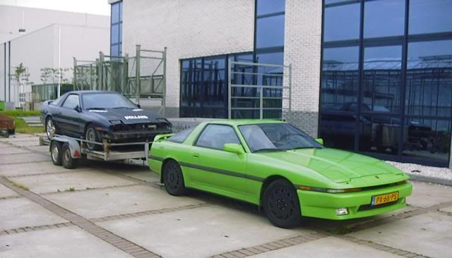

terrenceLP
Mar 22, 2011
81
Las Vegas, Nevada, United States
For towing stuff - Ahh-doy!
