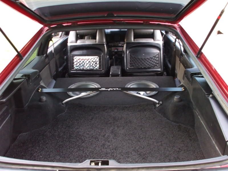

is it gonna be something like this???
or am I way off and its gonna be a rollcage and nitrous??

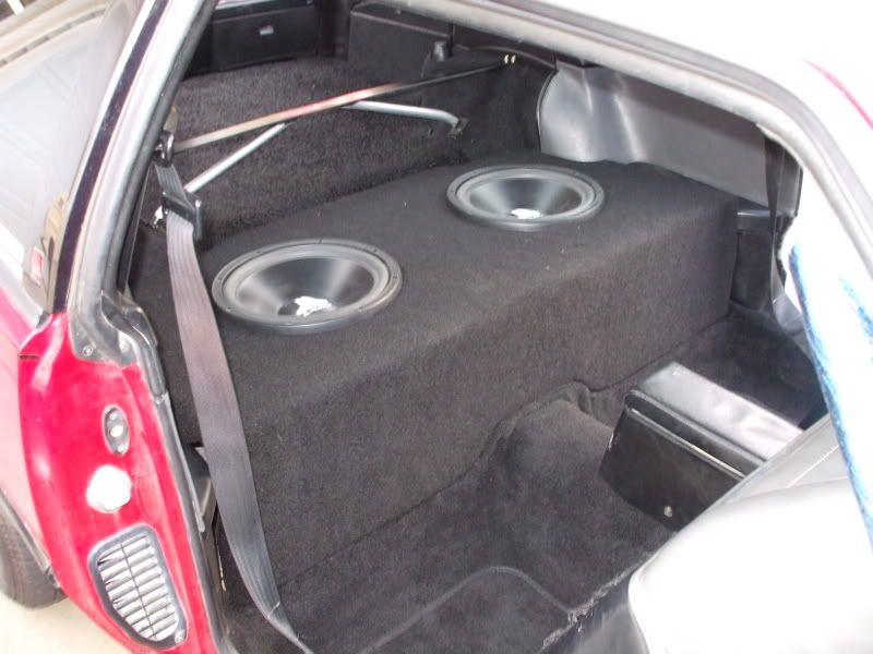

wood. The box is actually pretty small.
3/4" mdf 2 chamber box with 1 cu.ft per chamber, then it has a top and front facia that make it flushed out, which is made out of 1/2" particle board to save weight.
eventually I will make a custom fiberglass one with amp rack that sits down in there a little better.

I have a 1000 watt amp powering those two 12s
I will be putting in a 400 watt (on top of my 4x50 head unit) to power my 2x6.5 inch circles and 2x4 inch circles in the stock locations.
will have a total of 1600 watts in my small mk2...should be plenty loud..but well balanced and good sounding.
