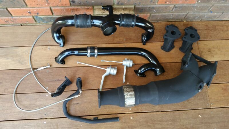

Because of the capability of the twins and the fact that they appear stock, I want to help these puppies breath and want those upgrades to appear stock as well. A larger intake will be designed since it has been proven that the stock intake arch is restrictive, and I will be purchasing my upgraded 'Y-Pipe' from the guy who proved this theory. Here is the Dump Pipe (aka Y-Pipe) as part of this kit he fabricates to run CT20 twins on a 1JZ;
The man is in Australia by the name of Kurt. Nice family guy. He does this on the side I believe. He mostly specializes with Soarers. Anybody who wishes to contact him I have his FB information as my only contact.

I have the same chinaman y-pipe as you have in picture. I've notice that the piping inside has a lot of overhangs that needs work for a smooth flow. But Kurt's dump pipe flows even better.
But I was posting about the cast iron headers and not the Y-pipe.

- Switching the Y-pipe to a Chinaman Y-pipe is arguably a gain at factory boost levels, let alone what it may achieve at higher boost levels. But what is even better than Ebay's Chinaman Y-pipe is Kurt's (optional 4.5"-5.5") Dump-pipe, which creates earlier boost and more room at the top end range.
- Removing the factory intake arch and replacing it by feeding each turbo their own 3" air filter (AKA twin intakes, also made by Kurt) has net 22WHP and gained 2PSI on a particular 1J Soarer in Australia.
