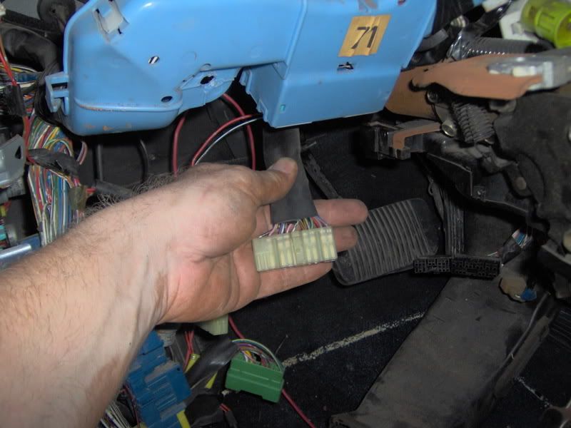

Ok, I have an 86.5 NA and an 87 Turbo parts car. I took everything from the 87 and converted the 86.5 to turbo. My 87 was prewired for a supermonitor but did not come with one. The 86.5 was NOT prewired. I bought a supermonitor from a friend and then I swapped the entire body harness from the 87 into the 86.5. That involved removing the dash. The body harness includes both fuse panels and TEMS and ABS wiring. My 86.5 did not come with either but that's no big deal so you'll have extra plugs if yours is not equipped either. 86.5 and 87 are essentially the same so it's plug and play.
Ok, supermonitor. There is a rectangular plug that hangs just above the break pedal. Pull the panel down on your 86.5 and if it has that plug then your are pre wired for a supermonitor. If no plug then you'll need to swap body harness. Here's a pic of the plug. You can look in my build thread to see what I went through to swap the harnesses. The link is below.
