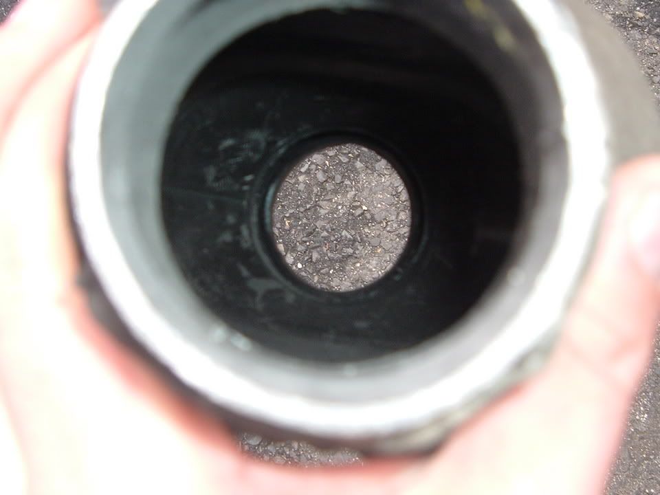

for all fo you good people, this is what we do with out cats here =>
after i gutted my friends cats in his monte carlo
http://img.photobucket.com/albums/v442/xride63/hollowcat.jpg
