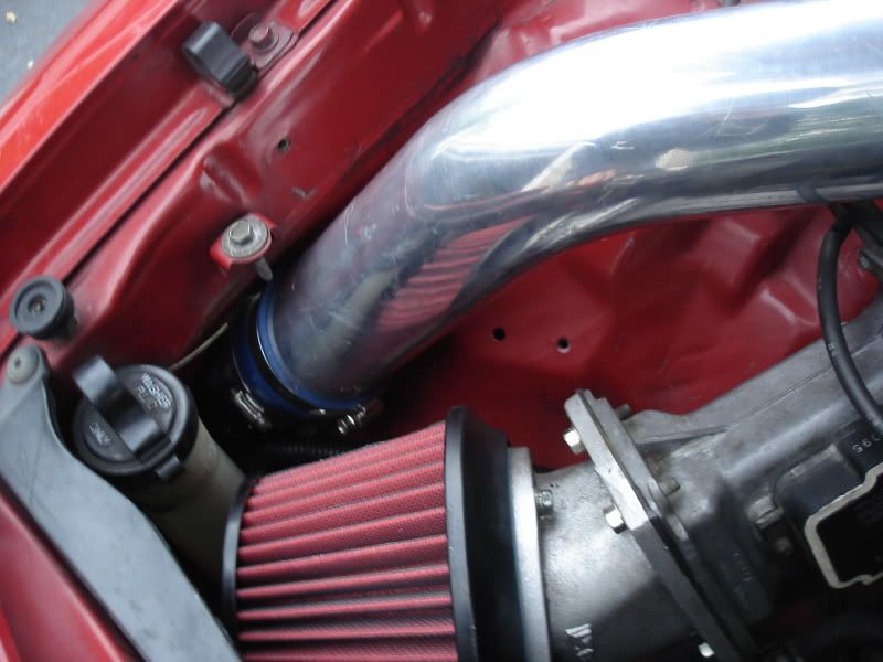

AEM filter with my own piping.... :)

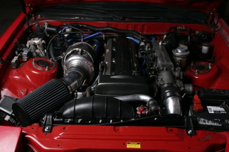

Blitz Sus Power ftw! and also for sale.
Too bad they don't make these with a 4" inlet. I think they are like ~6.5" inlet that connects to a bracket to the afm.
Going K&N 9" length univeral intake with new turbo setup that utilizes a 4" inlet.
