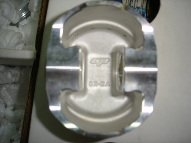

Is there a way to tell the difference between aftermarket and stock pistons without taking them out of the motor?
IJ.;937843 said:Stock cast in valve pockets
Forged machined pockets
turbodriz;937860 said:Brother man.... I hear u but I only understand what ur saying a little bit.
I want to try to Identify them while they are still in the block.
rtrdpenguin;938898 said:Wow so you can see the pistons when they're still in the engine? I had no idea...
IJ.;939339 said:Penguin: I have a bore scope
