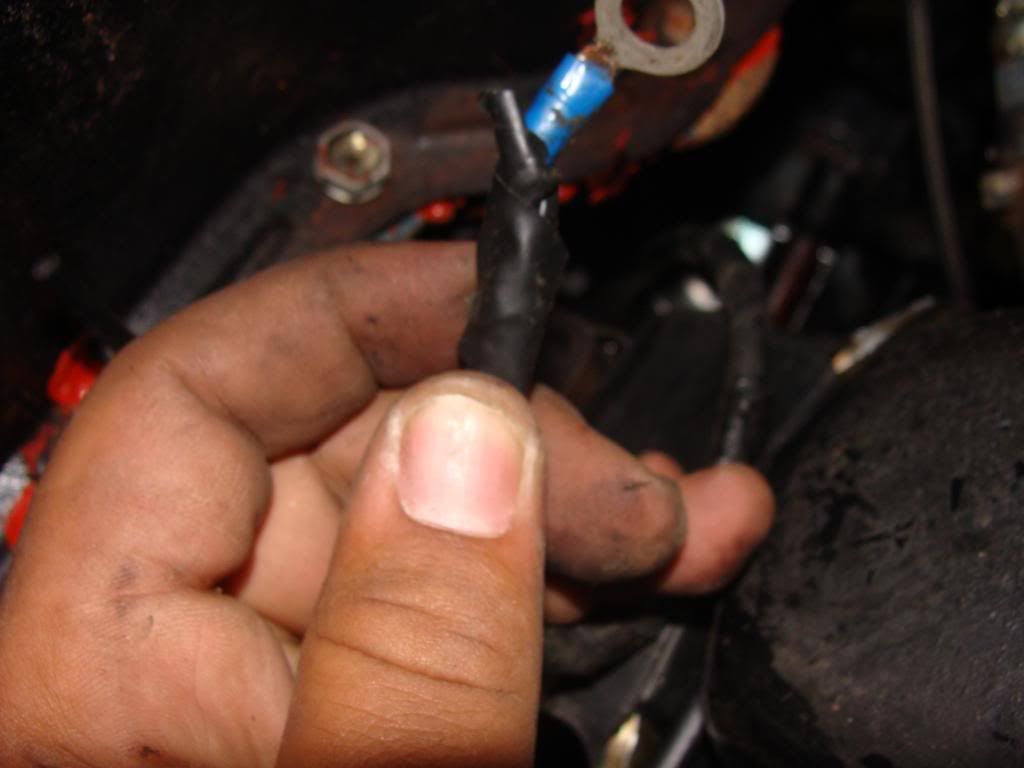

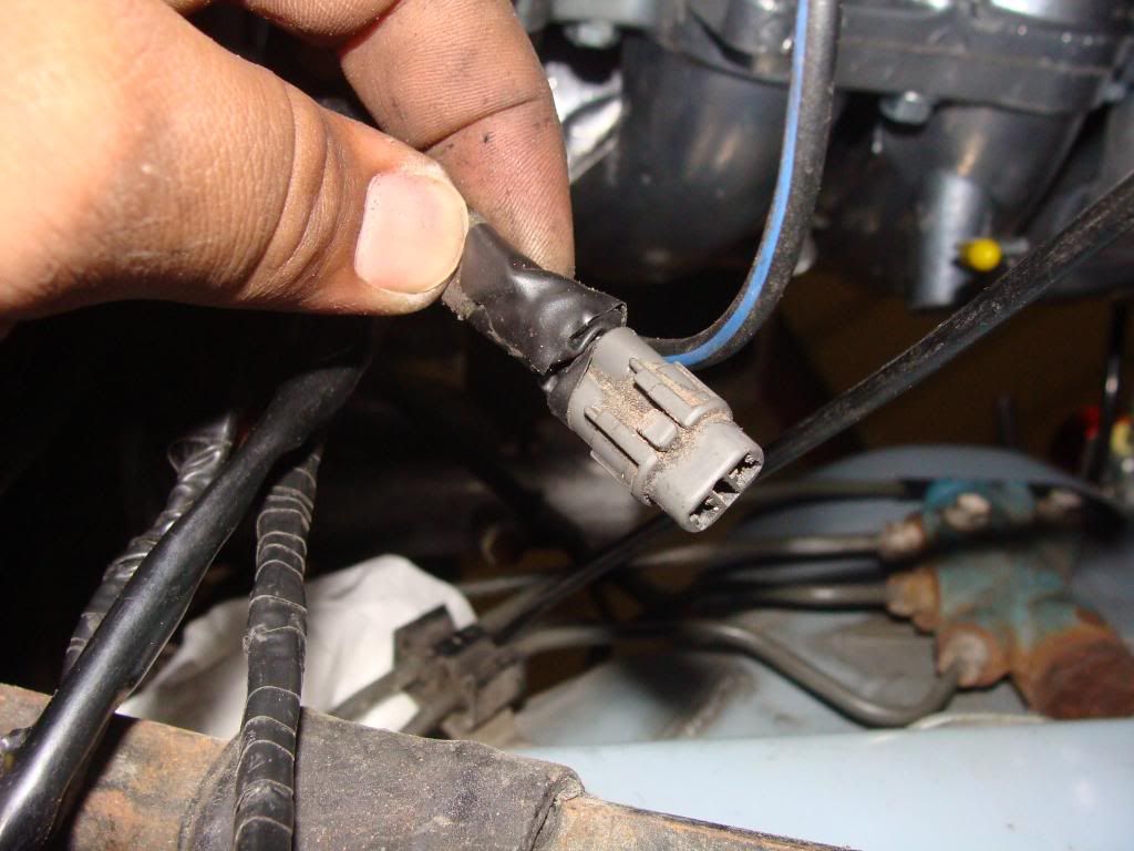

hey guys, i'm putting my motor together and its been so long i've forgotten a few things. I own an tsrm and have combed it but i can't seem to find what this is or where it goes. Perhaps i'm overlooking it.
It seems as though it'd go on the same bolt as the igniter does on the igniter bracket, but i don't wanna interfere with anything because of the igniter (i'm electically challenged) any and all input is appreciated, thanks.
I also have this problem
broke one of the wires off IN the sensor, and i don't have any wire to attach to really, suggestions?
thanks again
shaeff
Kurt is FTMFW x2!!!!
Super Moderator
10,586
9
Around
1) Reduces electrical "noise" from showing up in elsewhere in your electrical systems, etc...
2) Grab a new connector from someone with a parts harness. Solder or crimp on, voila. Make sure that whichever connection type you use, that it's 100% waterproof!
Poodles
I play with fire
Jul 22, 2006
16,757
Fort Worth, TX
You can depin that socket and fix the wiring.
Looks to be the temp sensor on top of the T-stat housing, so you'll have to get one from the right year if you want it off another harness.

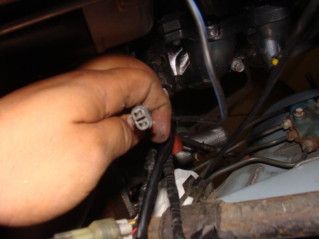

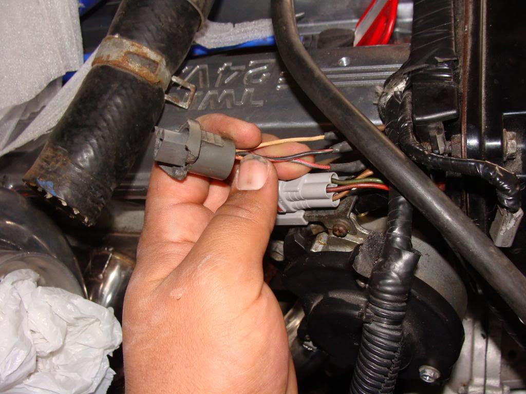

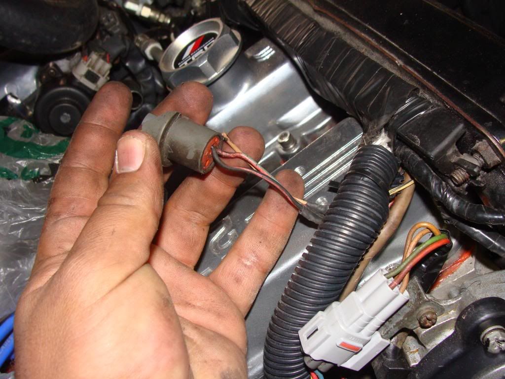

a few more.....bear with me here
its on the engine harness and i'm not sure where it goes, i can't find its mate...

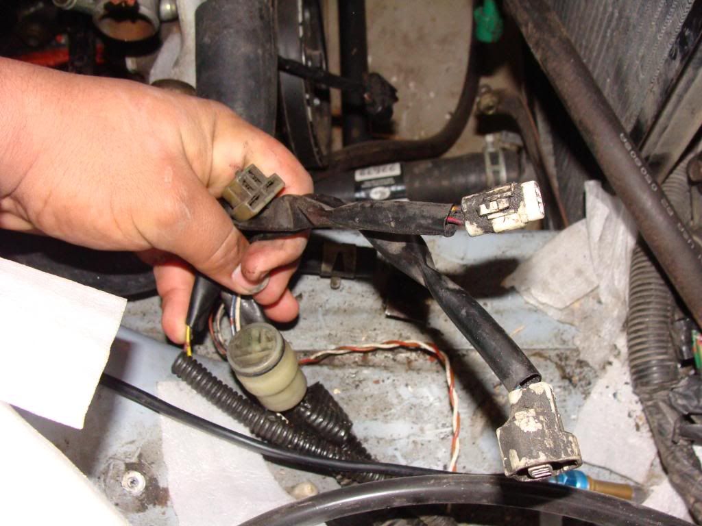

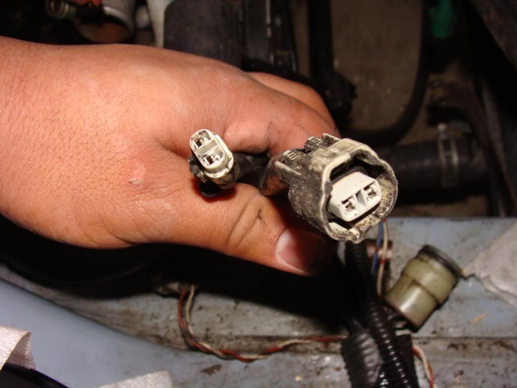

these are on the chassis harness and i can't find thier mates...

One recommendation is to grab a connector from your local pick an pull.
The first item is a electrical noise filter as already pointed out...
Supra_Villan
needs his car done
Nov 10, 2007
662
Wellsville MO
thanks, i didn't even think of that!(downpipe isn't installed so i have yet to mess with the o2 sensor) and no that last one is not a knock sensor, it is on the passenger side of the car and its on the body harness, not the engine harness. thanks so far to everyone!
kotu100
Nov 23, 2006
1,899
Easton, Ma
looks like the plugs in the last pic belong to the corner and fog lights on the pass side. not 100% on that tho.

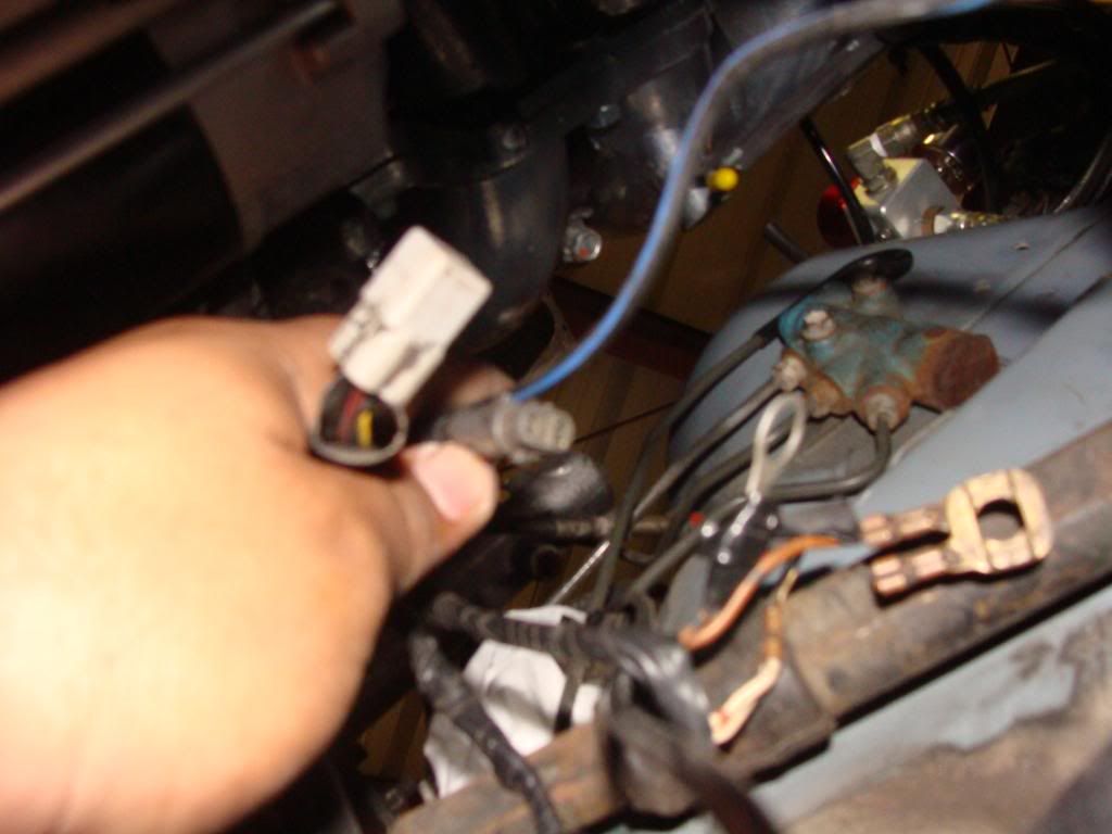

okey doke guys, back again,

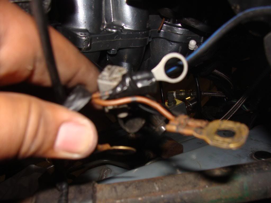

these ring terminals are on the engine harness and they go down towards the starter, which one of these goes on the starter, and where does the other one go? Or do they both go on the starter?
i know one of the wires on this is broke, i fixed it though

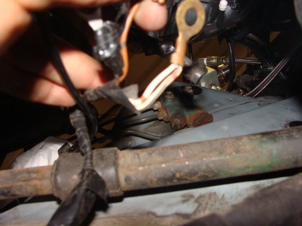

This one is around the same location
another one down there
different view
This one comes off of my knock sensor wire what would be a good place to ground this?

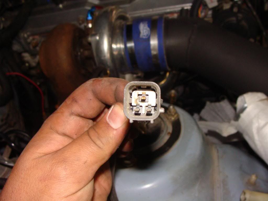

this is my o2 sensor wire (broken)
this is what comes off my o2 sensor
any way to cut the connectors and hardwire them, the colors don't match so i don't know what to put where
martin p
1JZ-GTE powered Supra.
Feb 5, 2006
215
East coast. UK
the Ring terminals are earths they bolt to the lower inlet manifold, there should be a bolt hole near no5 runner(From memory).
only wire's that goto the starter are a big black cable to the main terminal (from Positive terminal on battery) and a smaller wire with a brown insulating cap (and a female spade connector inside it).
