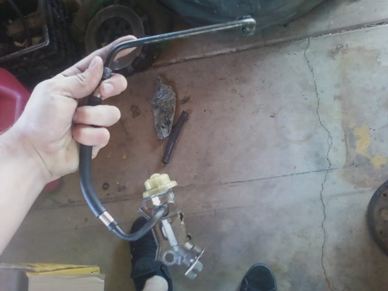

Anyway I dug through my stuff and found this:
it's from a 2jzgte. The owner went to a dm bypass line (haven't started it yet) rofl.
I'll think I'll borrow it to test my cut.

That setup wouldn't have fit my 1jz. The fuel line goes from the point in the tranny tunnel direct to the fuel rail. I'm still not sure that the FPD I had is a 7M or a 1JZ, but I put it in anyway with a slight "drill press" mod. lol.
Boosted 21 psi this afternoon, no prob.
