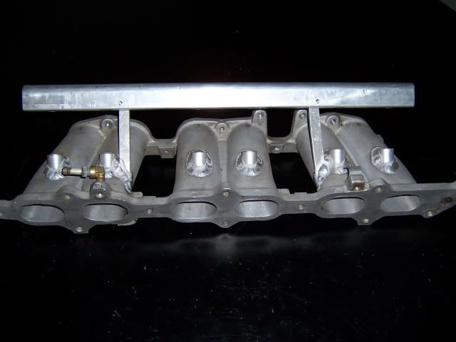

bioskyline
Oct 21, 2010
1,236
powell river bc
found pic!
oddly enough it is for sale here on the fourms.... http://www.supramania.com/forums/sh...e-ported-head-gm-trans-adaptor-etc..-for-sale.
