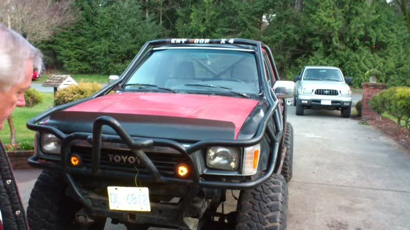

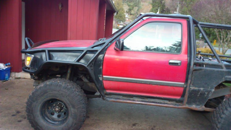

yae it will be going into my bush truck
so no inter cooler.... it just wonte do nothing any ways my truck does not move when trying to make it up rock face's and i want fast spool
oh I forgot to add in the fuel reg but I know about that
rad will be monuted in the back by my fuel cell
afm will have to be mocked with I know that
ps it's very easy to lower the boost on a stock ct26
2 ways of doing it
make the rod slighly longer or grind the compser houseing down
done it before works fine only can go so low thou
over all plan thus far is to keep it tame no huge power 200 to 220 is all I want for power
timing is the only thing. but I could just run the system in closed loop to lower the timing map if it's going out of hand
