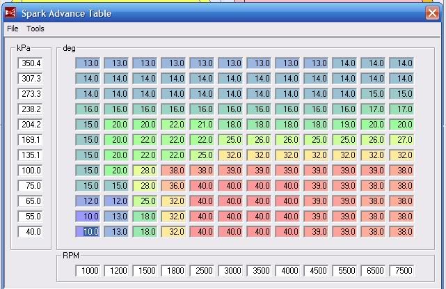

ok, havent gotten to change the coils yet but the problem loosing the ign signal is gone. i put a new coil pack harness on when i changed the plugs as 2 of the connectors on mine were broken so i just pushed the pins where they go. im guessing the coils were arcing to one of the pins cutting out the edis. thats all i can guess. i boosted the car and its fine. turned it up to 15, same, turned the manual controller to max which was 20psi when cold out. fine. though it spikes to 20psi on the gauge and levels off at 18. pulls great even in the heat. im guessing i need to add more timing up top as it kinda falls on its face shortly after 5k. i added a lil more and it helped so prolly still need more still. im still going to change the coils out and try to order the 25uf cap online since i cant find one local. the cat and afr's still bounce all over when cruising. what is clt?
