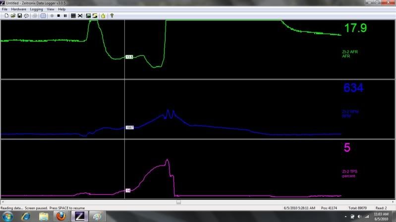

the problem seems to happen when I installed the safcII. the motor gets to about 3000 RPM and acts as if it was hitting fuel cut. im only boosting 9 psi, courtesy of an aftermarket gauge.
the AFR seems to be good until it hits 3000 at WOT and cut and chugs. i let off and it goes back to normal. if i am to slowly creap my way up to WOT it still chugs but, very slightly.
here a screen shot.
here a screen shot.
