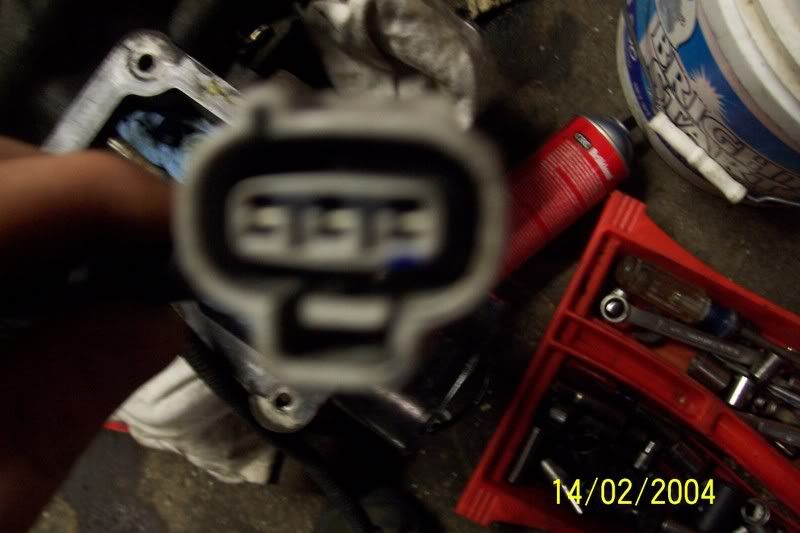

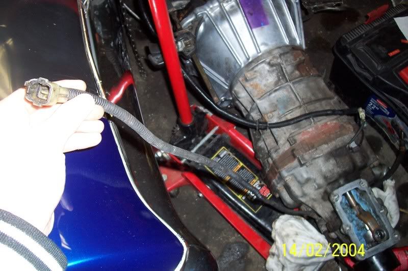

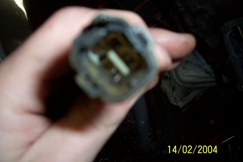

I just mated my r154 with my 1jz in holy matrimony and the plugs that go from the tranny to the motor harness dont seem to match up, i might have the wrong plug from the harness but this is the one i think it goes to, tranny plug has 4 in a square and the plug from the engine has 3 straight across. This is a soarer harness.

there is a long set of wires that come from the r154 to somewheres in the engine bay. its 3 wires in a square plug.

pictures:
long wire from transmission
plug on the end of that long wire
plug that goes from the engine, its long and it goes from the other connection on the transmission.

First pic looks like the reverse light switch thing.
The second one.... might be a speed sensor.
Does the R-154 there have the MA70 style sensor plug thing in it? If not, take one out your old transmission, and pop it in. If that R-154 came out of a soarer, put the shifter assembly back on it, and sell it to someone with a SC300/MKIV ;)
