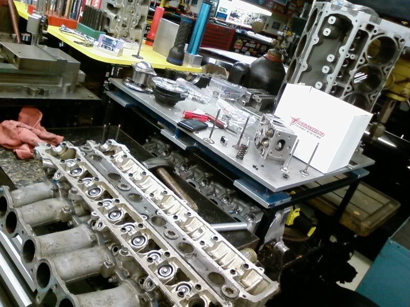

quick pics
Stock Intake
Titanium Intake (still wasnt fully done)
Our donor 7M head
More custom valves
