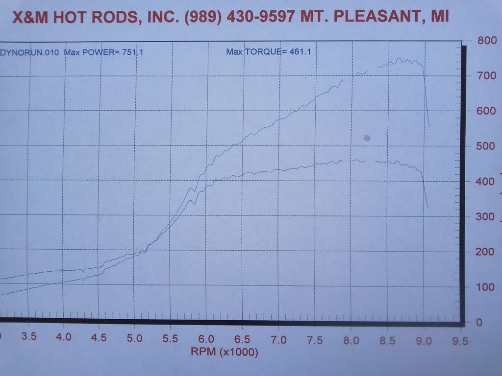

It was a boost spike... there was literally no tuning. The first (base) run was 409whp at 11psi the second spiked to 20psi and made 566whp before we got out of it so the engine wouldnt blow.. this was by no means peak power it was just an accident. Im sure with tuning and more fuel itll be higher.. not to mention my cam gears are still set at zero so if i advance the exhaust cam about 4 degrees there is another 20+ hp in there... Ill be happy if it makes 600whp on 93 octane pump gas. It made 475rwhp at 14psi on the dyno.. i have it at about 15-16psi now and as you can see on my wideband in the last vid in post 23 of this thread its a very conservative (rich) tune so it has a lot more in it.

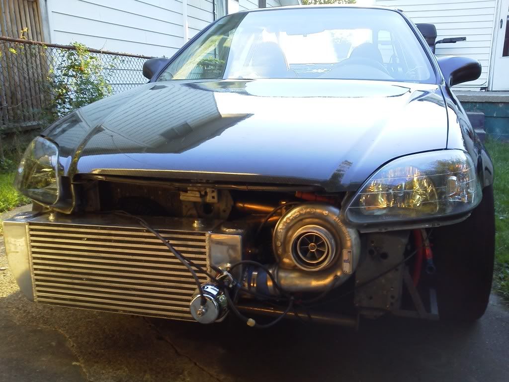

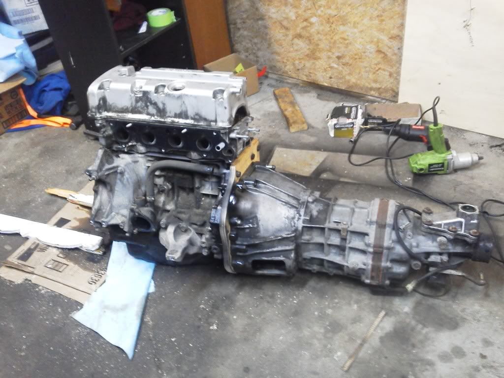

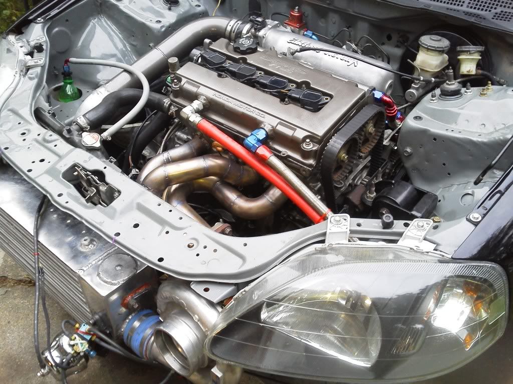

heres a few pics/vids for ya.
bunch of vids on youtube at the track, had alot of problems this year should be much better next season.
http://www.youtube.com/watch?v=7jaunmYzdTQ
and this is a supra forum so
going in to supra honda k24
