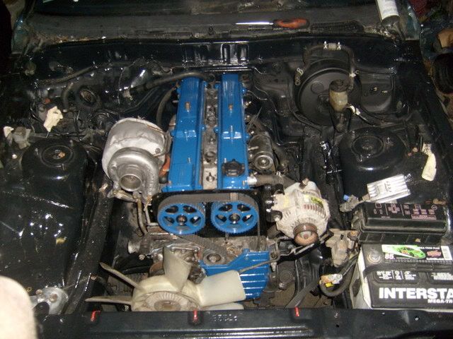

i have just finished repainting the the engine bay. i used an epoxy primer coolor and clear. i think it came out alright. youll notice i choose black. i did that so no matter what the extiorer color goes to the engine bay will match. my plans for this car after it is rebuilt are to enjoy it for the summer and then i want it to go back under the knife.

this took like an hour and a half. with the bigger hot side of the turbo the heat sheild woudnt fit anymore so i figured this would gring under hood temps down (i wrapped the down pipe too)
bagged
primer down
color and clear

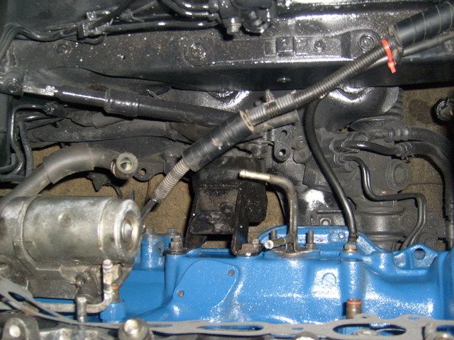

motor 90 percent done i still have to clean up the valley
back in everything wrapped up. waiting on parts

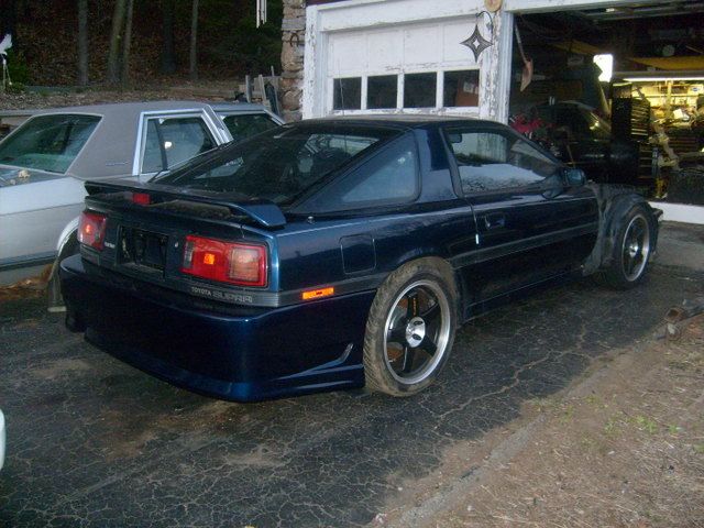

i didnt get too much done this weekend. i am waiting for alot the parts right now. i did get ansy and i mocked up the body pieces to give myself an idea of what need to be done madifiction wise. the back seems realitively good the sides are gonna be horrible. anyway. heres a look.
this week i think i am gonna do the body work while i wait for part. i am undecided on how much i can do with the parts from the na car i have because i dont want to run into having to take off parts i have installed becasue i cant get to stuff in.

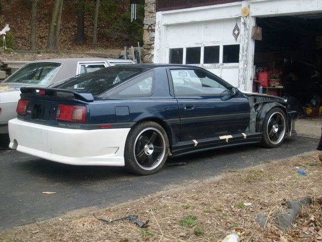

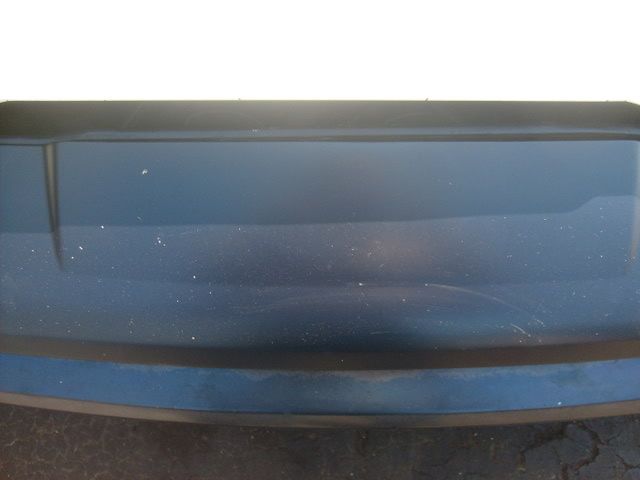

its tuesday after work. i was able to paint the back bumper monday. i let the paint cure until today. so i mounted that up. i love it. do you guys have any opinons on it. with the sides and lip i chose? anyway after i mounted that up i started taking parts of my old car. so that they can go on the new one. and so my buddy can have the old motor since that beast ran like a freaking champ! anyway thats my update for now.
here is the back bumper done. tomarrow im gonna contiue parts swapping and the side skirts from above. they need alot.

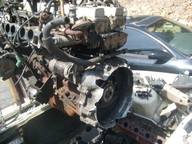

also on thursday i pulled the old motor out of my na to give to my good friend. check out the bellhousing!!!!! this is what lead to the purchess of the new car by the way.

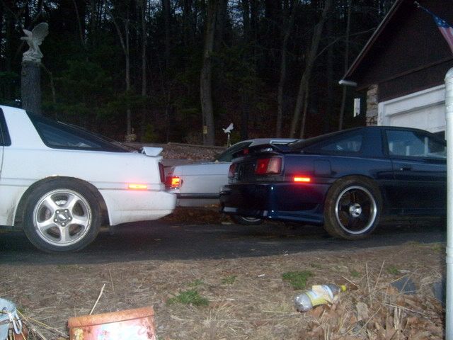

old and new supras(i think the back bumper makes the back end look good)

bellhousing:3d_frown:
running the fuel and vaccum lines is gonna be a pain since i never got to see them before they burned away

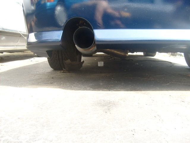

anyone got any ideas how i can move the exhaust over like an inch its a blitz nur spec and coolezze dp ment for a 1jz mkIII

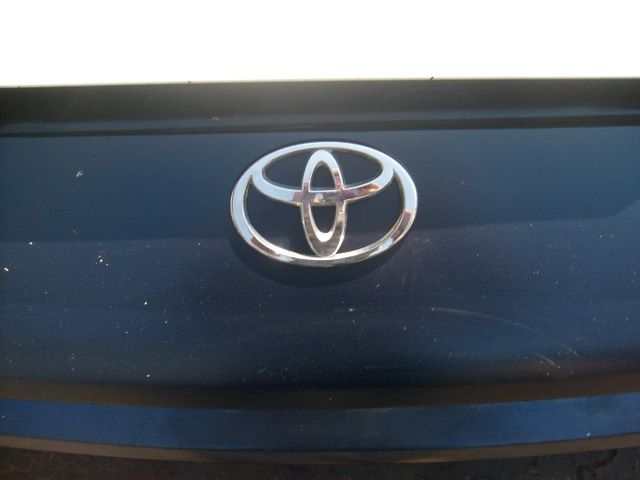

weekly update time...sorry no pics for now. i finally scraped the money together to get the ret of the parts. should be like 2 weeks before they come in yay! i put my interior back together, hookd up the driveshaft, speedo cable,brake booster,throttle cable,clutch master, and then i moved onto body parts. i took the headlights and upper bumper from my other car and sanded them and preppe them for primer. then i took the badge out of the upper bumper and filled the hole. i smoothed it out and am going to put a regular toyota badge off of a prius on it instead. so i prmiered those and then put down the base color coat.

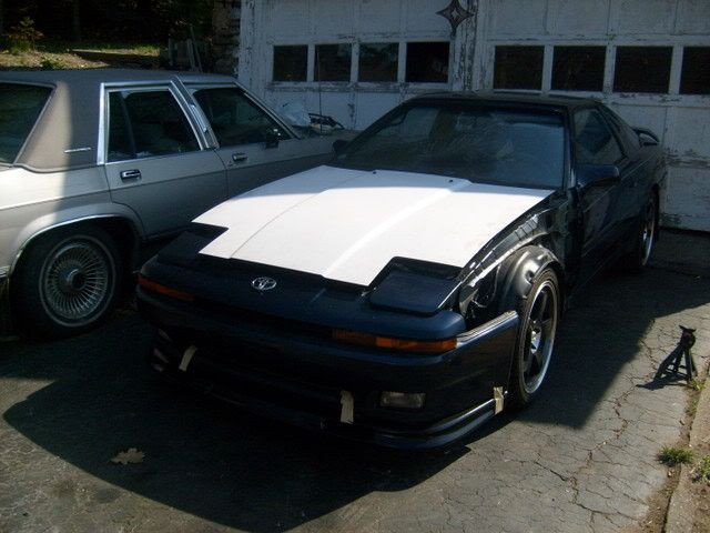

i lies i do have som pics ready.....please keep in mind none of this is lined up...i was just curious so i mocked up most of the front end.
Front end mocked up (mainy to see color matching)
Filled for new badge
Big prius badge
