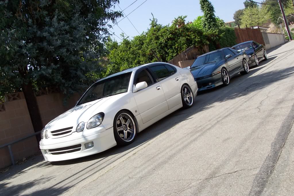

HT5SSilverSupraT;970036 said:
Curious what your width/offset/tire size is on the wheels that you don't rub. I got some 19's with a wide offset but I'm planning on pulling my fenders.
Rears are 19x9.5+24, 275s. You might have to run 265s, but that's entirely dependent on your suspension setup. Fronts are 19x8.5+27, 235s. I have JZA70 Bilsteins w/ H&R front springs and Neuspeed rears.
Your car might be a whole lot lower so what may work for some, for others... not so much.

Cool thanks for the info. The rims I have are almost exactly the same 19x8.5 +25 fronts and 19x9.5 +20 rears. The tires I am planning on getting are 235/35/19 fronts and 275/30/19 rears. I'm on Tein coilovers and plan on having them almost all the way down but that's after some suspension and fender modding.
Thanks again!

im like truely inlove! hehe funny thing is up here in canada i have friends with real aristo's, soarers, and i own a real TTR. Love the cars tho man!
