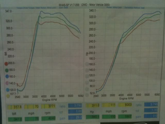

HI
just had my car tuned today
stock long block
stock intercooler,
2" hard pipes
Ebay DDP
3" exhaust, no cat
CT26 57 trim 10 degree clipped exhaust wheel
running 14psi

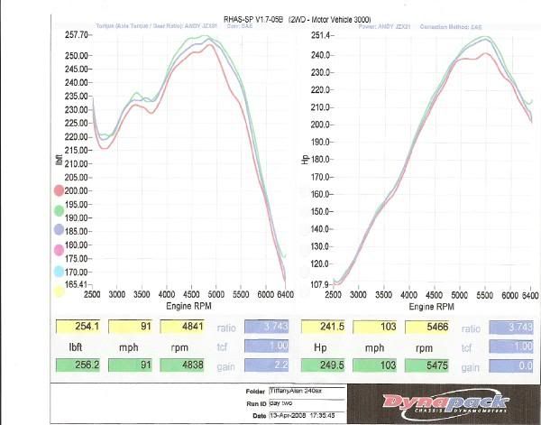

this is the dyno from when it had a stock turbo running 7psi

What type of dyno was this??? Must not have been a Mustang dyno by the looks of it. Because I did 300 to the wheel on a mustang and I was at about 16 psi with A/F at 11.1

Afr were in the 11.5-12:1 range
Motor was rebuilt to oem specs about 18k miles ago with an hks MHG & arp head studs, I believe it has na cams
this was on a dynapack, it reads about 7% lower than the other dyno jets on the island
sorry, no mustang dyno's on the island, your afr is kinds of rich at 11.1 though, you may be able to gain a little more power by leaning it out a bit
