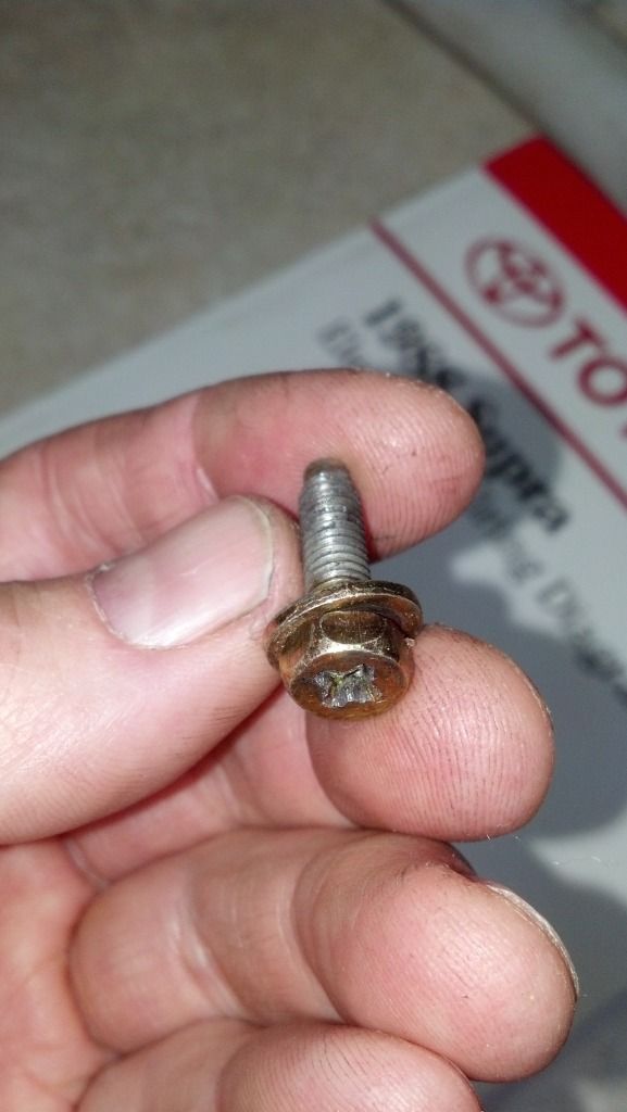

I just purchased a stereo mounting bracket from eBay for my 86.5. My car didn't come with one at all and so I'm wondering what size/type bolts or screws I could use to fasten it to the dash?
M5 8mm head like all current toyota radios. Not uncommon. I replace radios all the time at the dealer i never use the phillips as theyre too tigh and strip for it. Always use th 8MM
