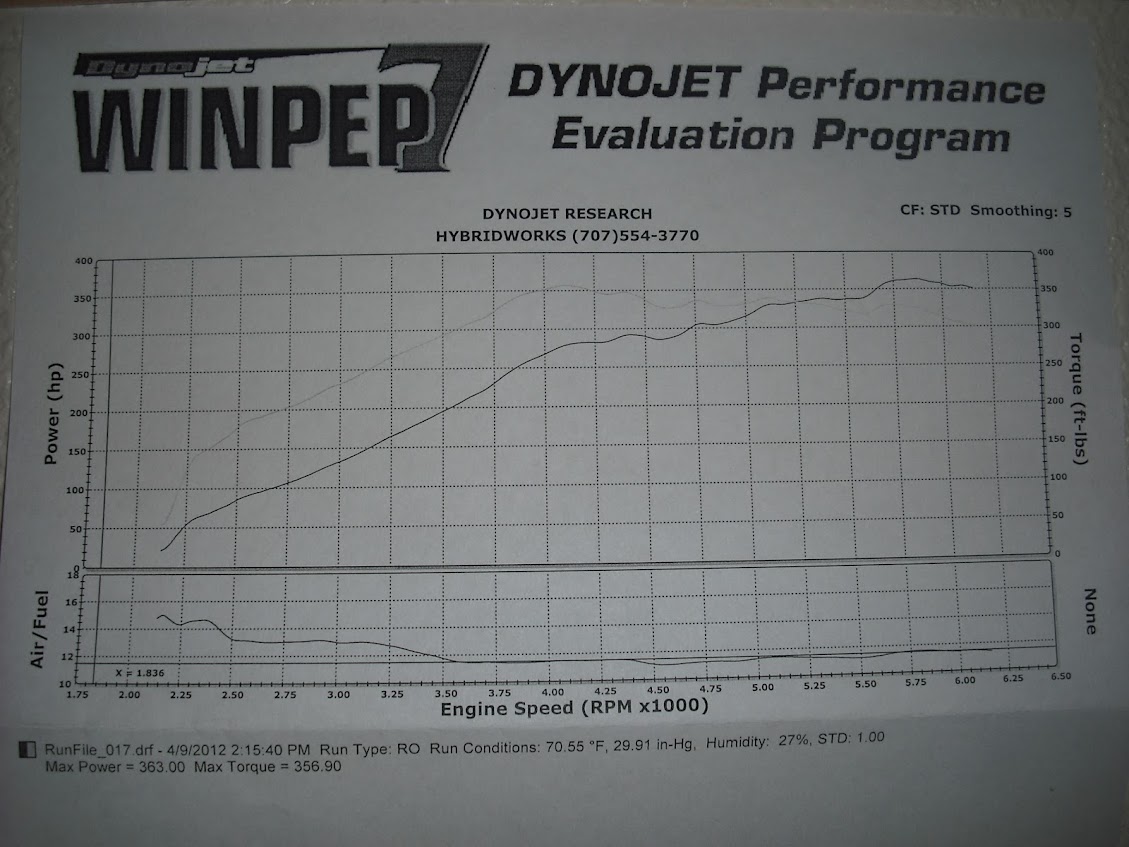

I've had this turbo since last year and I daily drove my car back then. This was my setup was the usual lex/550, afpr and piggypack. Stock head and cams. Bottom end is built but nothing special that'll effect the hp numbers much. My 5857 stock wastegate pressure was ~10psi which netted 267hp. 14psi increased hp to 363 and ~18psi increased hp to 400hp. I run 91 octane gas so on the 18 psi setting I also ran water/meth injection.
During tuning on the 18 psi setting we had some stubborness getting the wastegate to hold that pressure with an aem tru-boost. I tightened the wastegate actuator arm and now it'll hold 18 but occasionally see 20psi spike when its cold. I nearly have to max out the setting on my boost controller to get 18-20 psi.
Spool starts at 3500 and full at 3800 depending what gears I'm in. Please excuse my noobness at driving a stick. I just started driving a stick when i Made the video. I don't know how to embed so you can just click on it.

Overall it was a good setup but I felt like the stock ecu and piggyback was holding me back. If I had a standalone I'm sure I could have hit over 450. I haven't had any problems with this Precision turbo.
I just noticed this geared towards the 5557. I wouldn't bother with the smaller version. Go 5857 or go bigger.
I should also mention that the pictures on SP's website are the older bolt-on that used water lines. The new turbos are waterless.
