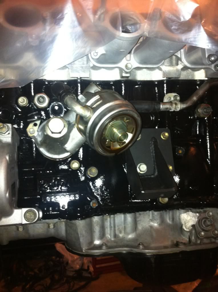

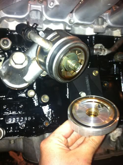

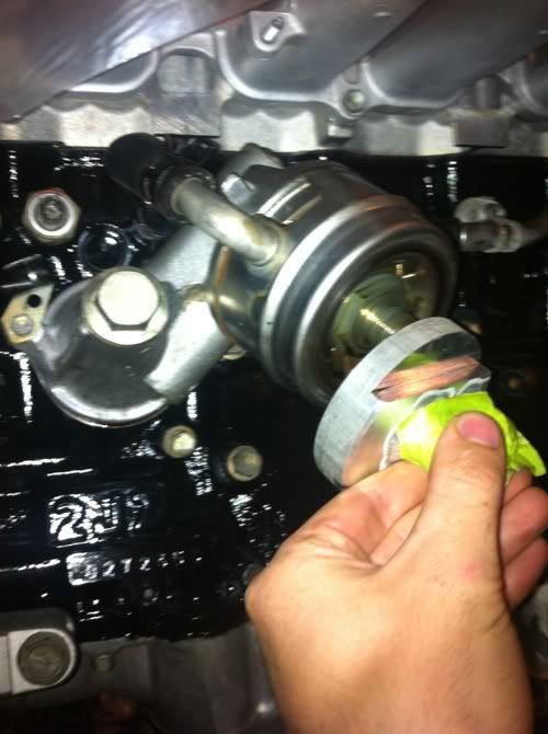

3. Have an oil filter relocation kit, and I believe this piece just threads in place instead of the oil filter, and NOT directly on the block (would need a threaded adaptor etc if that was the case). I will be making my own lines going to a oil cooler, with a thermostat in line. Correct me if this is wrong? Pic below.

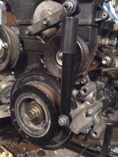

4. is the drive belt tensioner dampener a necessary thing to have bolted on for my swap?

4) You mean the serpentine belt tensioner? If so, yes. If you aren't running A/C or power steering, there are setups to keep it. DM sells it. I have the info in the JZ thread.

4. I dont mean the serpentine belt tensioner itself. There is a shock type dampener that bolts on to the tensioner. It was on the engine when I got it, but I dont know if its necessary to keep it on or not. I will be keeping my A/C and power steering. Check Pic below.

You can remove that shock. It was available on auto cars here in the states. Manual cars didn't have it.

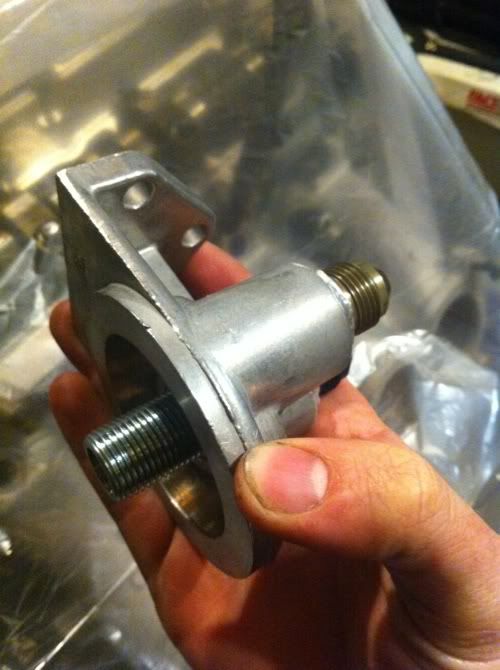

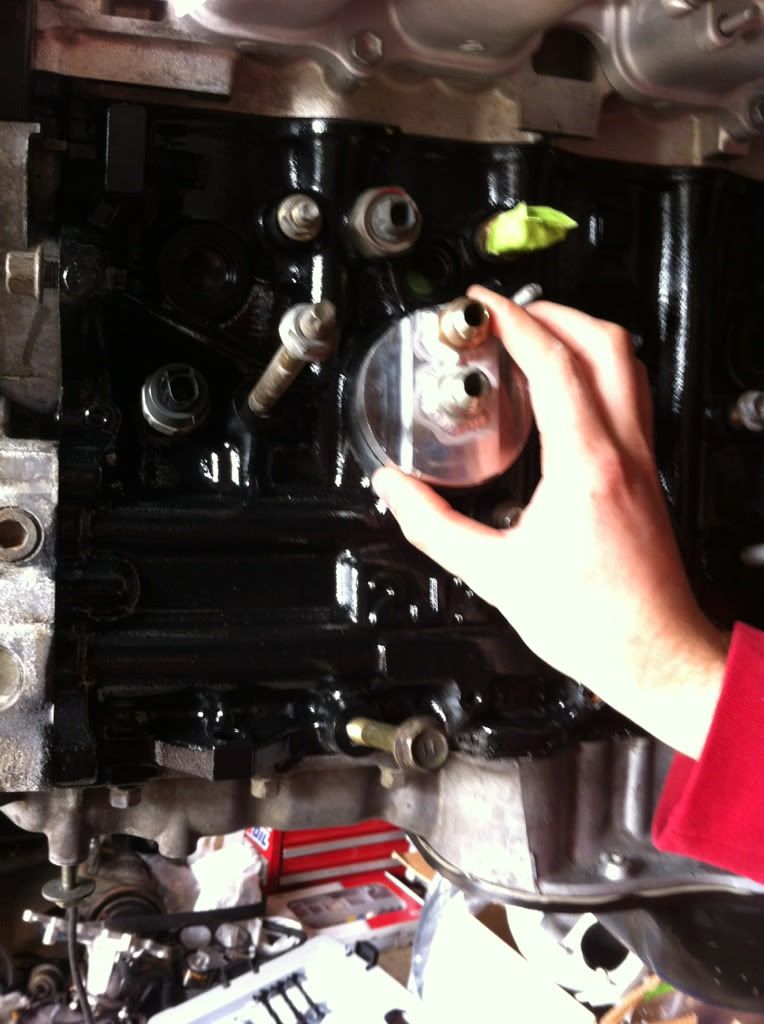

Here are a few more pics of the oil filter relocation setup...
Click this link to see what I have:
http://store.driftmotion.com/static/i-bpm-202-28.php
I will mention, if the part Im holding (part of the oil relocation kit with no mounting bracket holes) were to thread directly on to the block, I would need to thread this into the block first, in order for that part of the adaptor have something to thread on to:
http://www.titanmotorsports.com/oilblad2j.html
However, if that piece (part of the oil relocation kit with no mounting bracket holes) is supposed to take the oil filter's place, then it threads directly on to the stock assembly - instead of the oil filter.

4. No if you have the automatic tensioner.

Ok the non mounting bracket piece is for placement on the motor, you can take off the entire housing and get the threaded tube that is needed as you listed or keep the water housing and screw onto the fitting thats there. The bracket piece has a thread so that the oil filter can be relocated. Hope this helps.

Just for reference, if anybody ever needs that Ford threaded pipe for the oil filter (to use a relocation kit as the stock threaded pipe is not long enough), Bob Allen Ford in Kansas has some. They quoted me $38 plus shipping. Their phone number is 913 381 2999.
