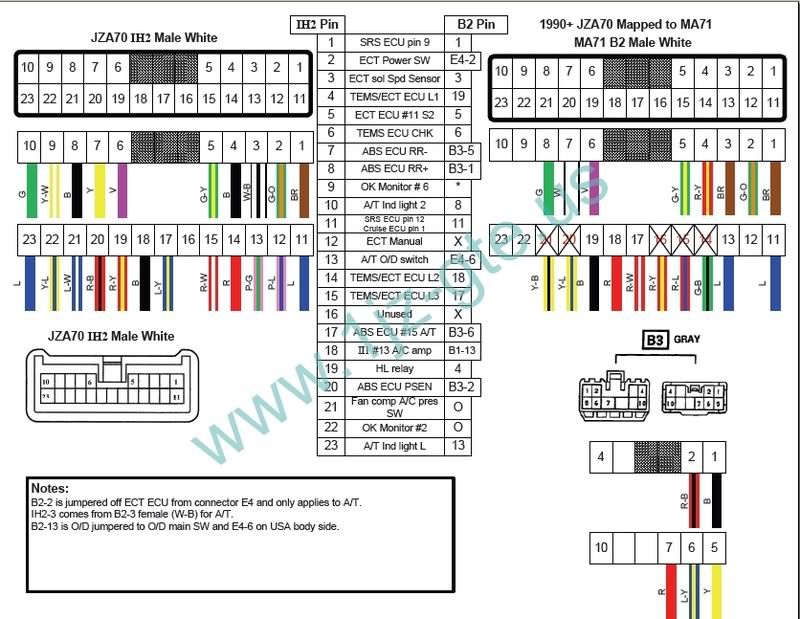

Also, b2 plug, WHERE IS IT? i have everything wired except for that and it's killing me. For 88 models are the colors of the wires different?
