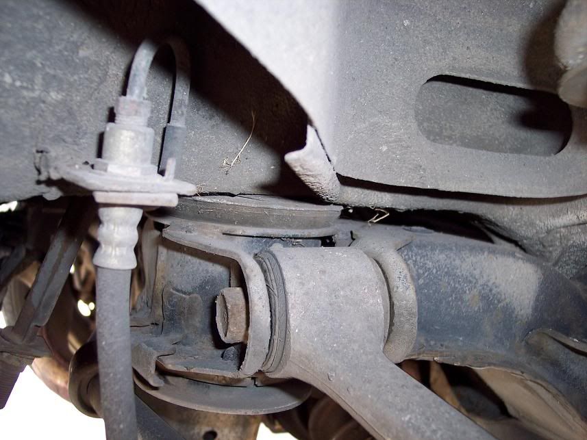

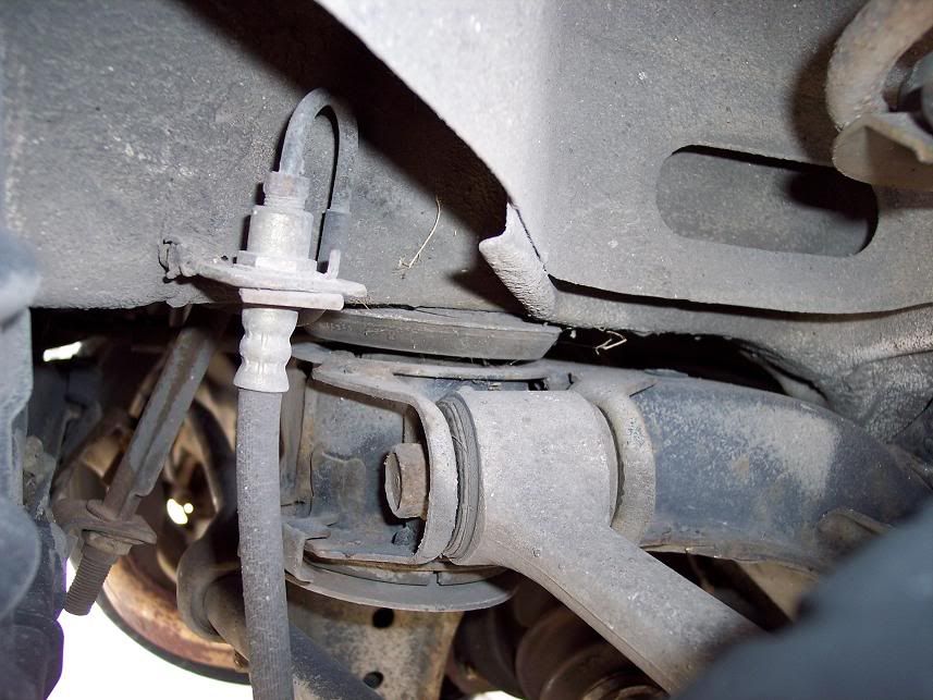

When you take the cars weight off the subframe and your bushings look like this.
Weight off:
Weight on:
So thats my next job.

Poodles;1278680 said:
well what kinda shit is that?! who the hell in upper management at toyota ok'ed that idea.
in all seriousness tho im prolly still gonna check and see. my car is older than me and its got some miles so i might as well check.

They're supposed to insulate the noise and vibration, can't do that when they're solid...
Try retorquing (definately can't hurt as it's supposed to be done at specific intervals but never is), but I bought you'll see too much change...

Would this be corrected by installing new bushings and retorquing those bolts? I'd guess that having that much up and down play can't be good for handling and rife comfort. The other day i was thinking about this, then I run into this thread. So yeah, I'm gonna check mine asap.
True. well good to know that they are supposed to do that to an extent i got very worried when i saw that.

im not sure i wanna retorque first and see what happens but one day down the road this cars gonna get a full ES bushing kit and prolly soild subframe spacers or the ones BIC offers.
