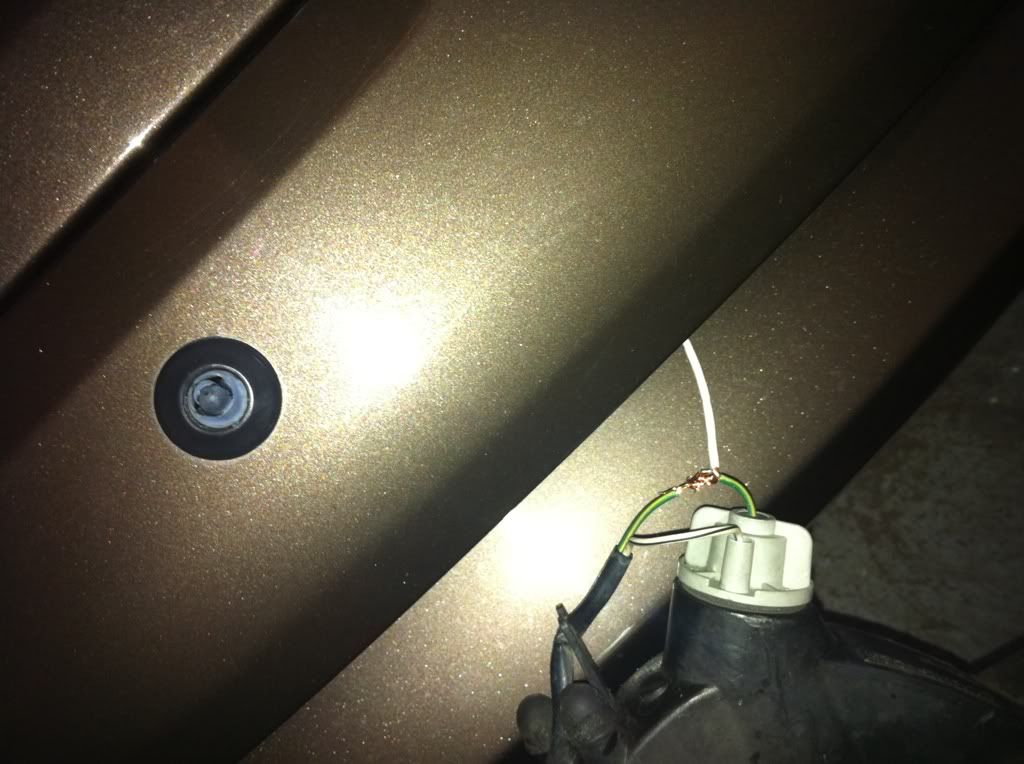

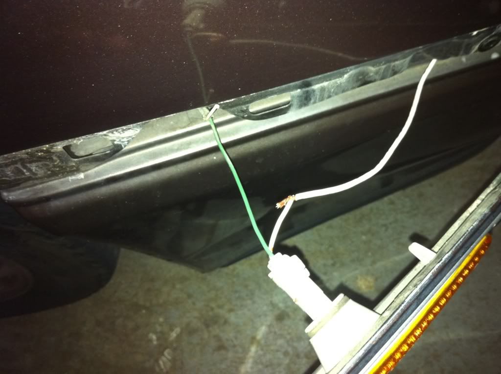

So I am trying to do the mod where the front side markers blink with the turn signals. I did the wiring just like the guide and for some reason the side markers will only blink with the turn signal if I have the running lights or headlights on. But with no lights at all on the side markers will not flash with the turn signals.
Here is what I used:
http://www.spooledup.com/content.php...idemarkers.php
My sidemarkers do what the sidemarkers do in the second video on the bottom.
But not the first.

So one side of the car I used the scotch lock connector and butt connectors like the tutorial. But the side I am putting pictures for is my tiring the wiring together in hopes a more "direct" connection will help lol.
