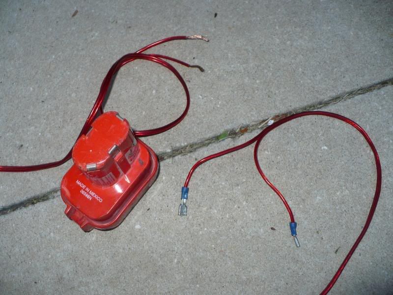

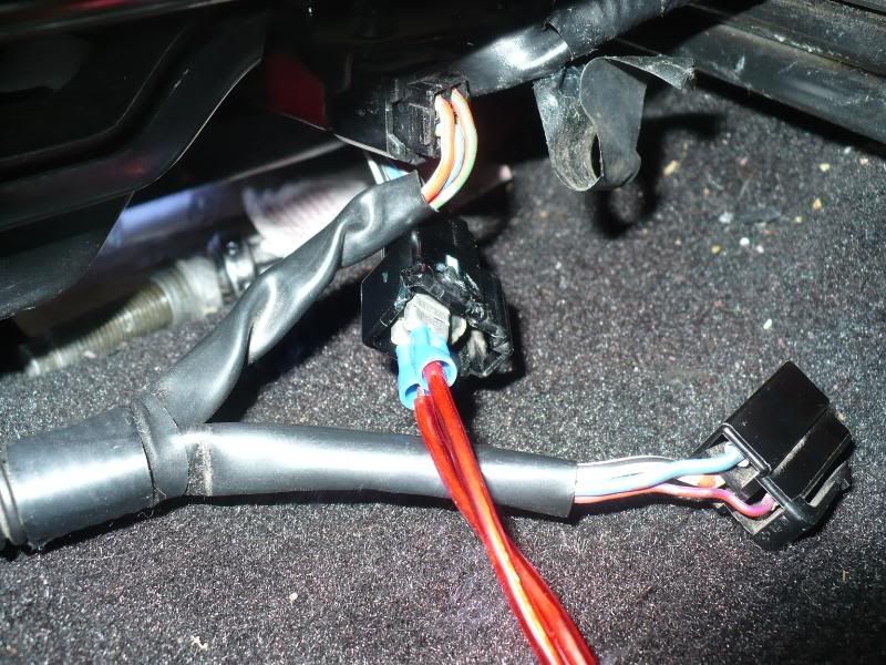

ok so you are going to go to the right rear of the drivers seat and there is going to be a three piece plug with a blue and white wire side by side. your going to unplug it (you may have to rip the one part down from the bottom of the seat, its only a plastic clip) then you need to take some speaker wire and put some plug ends on one side and strip the other side. plug the two wires into the side by side ones (blue and white). with the are striped end you are going to take a car battery or battery from a drill and touch the blue to + and the white to -. this will get your seat to move
note: i believe to controls were backwards, foreward was back... i may have just turned the wires around but it did work
