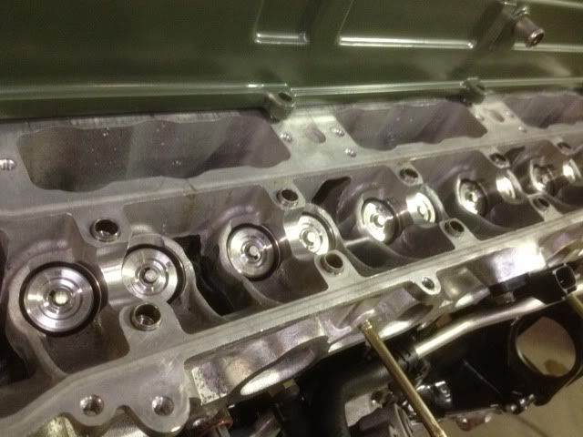

BC springs and retainers are on the way. No real progress other than getting all initial valve shim thickness measurements. I'm hoping I don't have to shim every single valve with the new cams. Should be able to order the cams in 2 weeks.

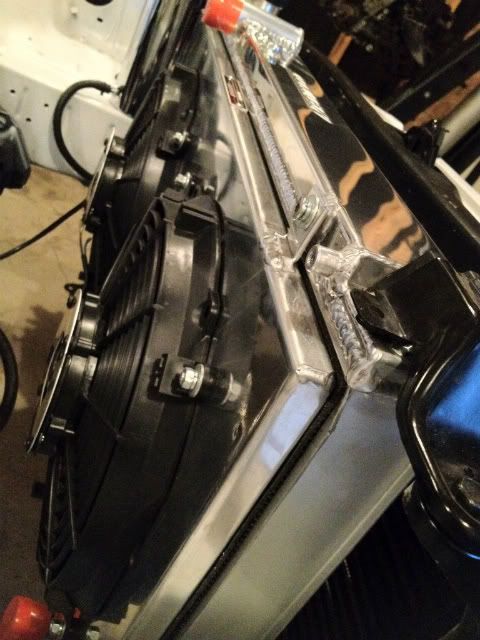

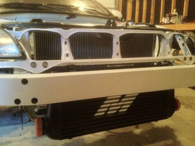

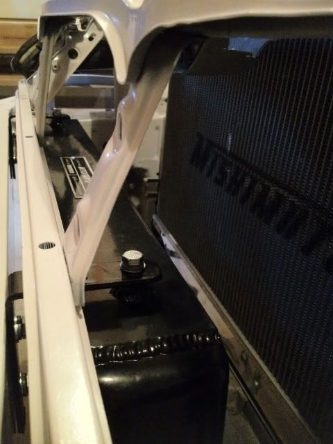

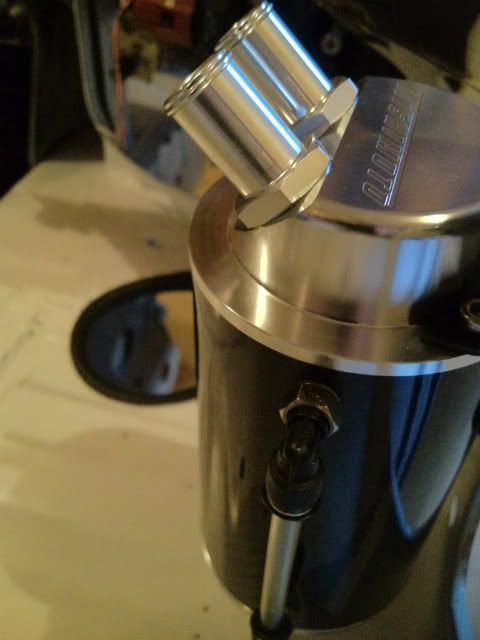

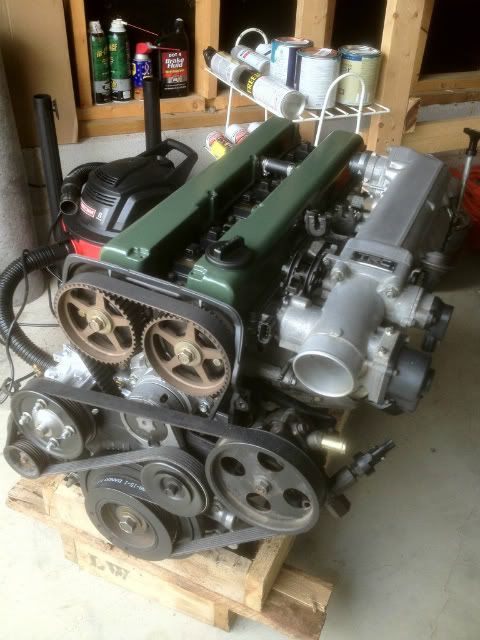

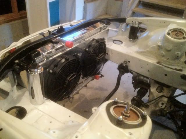

Made a little progress. It's been a while since I've lurked on here. I've been a work-a-holic :( I got in touch with Mishimoto and they hooked me up with a partial sponsorship :) Grabbed a jza80 radiator, fans/shroud, silicone hoses, intercooler core, coolant overflow tank, and catch can. Fabbed up some brackets and got everything mounted in the car. Also finished the motor and took it home. Got the wheels painted white. LS400 brakes installed. Slow progress but it's better than none!

very cool man... what the story with the "M" charge air cooler?
edit* oh must be for mishimoto? first thing that comes to mind when I see M is bmw performance, lol
