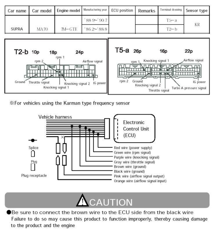

bougt a used SAFC.. was wiring it in today. was wondering if someone had a diagram for 87-88 safc install?. i went on apexi's site.. they had the diagram, but i wanted something with a generic illustration? i searched on here only found a hand drawing. also, if the power was hooked up, and the 2 ground wires are hooked up, should the afc turn on with the car? or do all the wires have to be hooked up?
