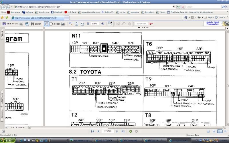

Ensure you have the Correct Diagram for your Wiring Harness. One Listed is for a 89+

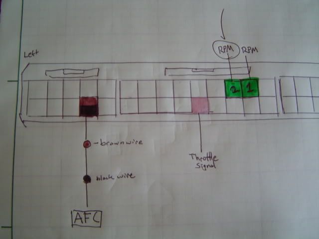

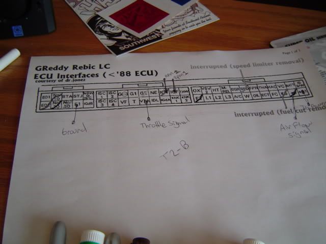

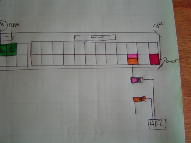

here man. it took me so long to find these....this is for pre 89
SAFC-II to Vehicle ECU
Red (Power) to +B - Black/Red (T12)
Green (RPM) to IGF - Light Green/Black (R3)
Purple (Knock Sensor 1) to KNK - White (Clear) (S5)
Gray (Throttle) to VTA - White/Red (S11)
Brown (Ground) to E1 - Brown (R14) (Closest to ECU)
Black (Ground) to E1 - Brown (R14) (Away from ECU - Harness Side)
Pink (Airflow Output to ECU) to KS - Light Green/Red (S2 - ECU Side)
Orange (Airflow Input from AFM) to KS - Light Green/Red (S2 - Harness Side)
