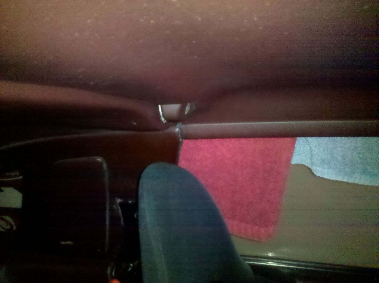

i think you might have issues with head clearance if you try to build a full cage while retaining a fully functioning targa.
you could always drop the a-pillar bars down a bit but then its gettin close to your head, custom seat rail is an easy fix for this.

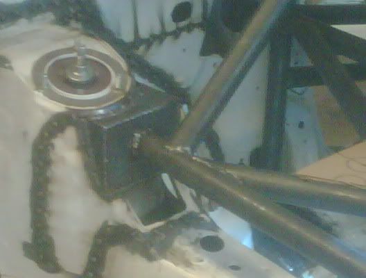

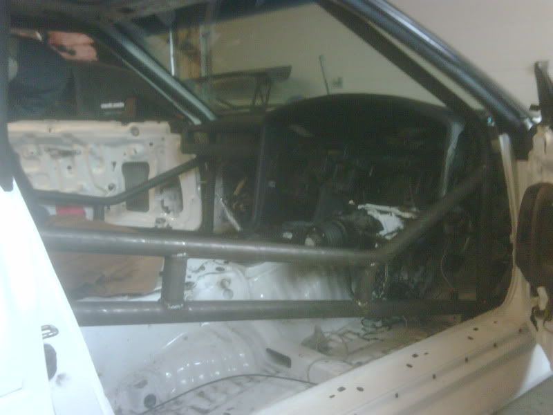

here are a couple shots of some of the cage work we did. the door bars were a cool idea but id go for something lower if i did it over

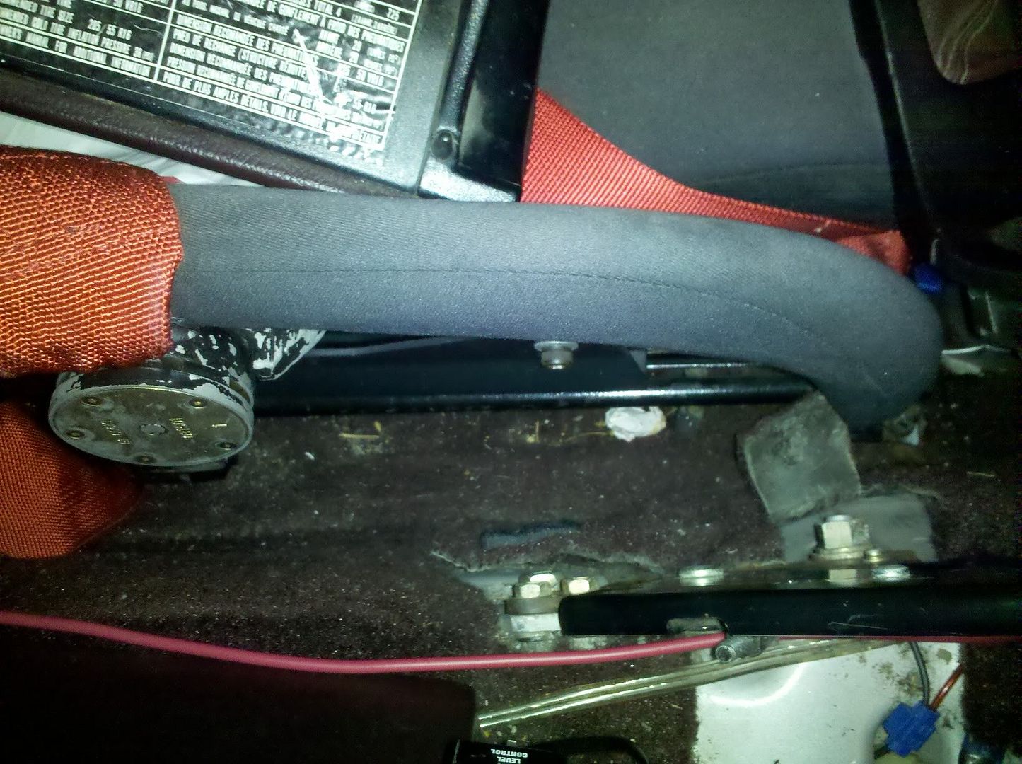

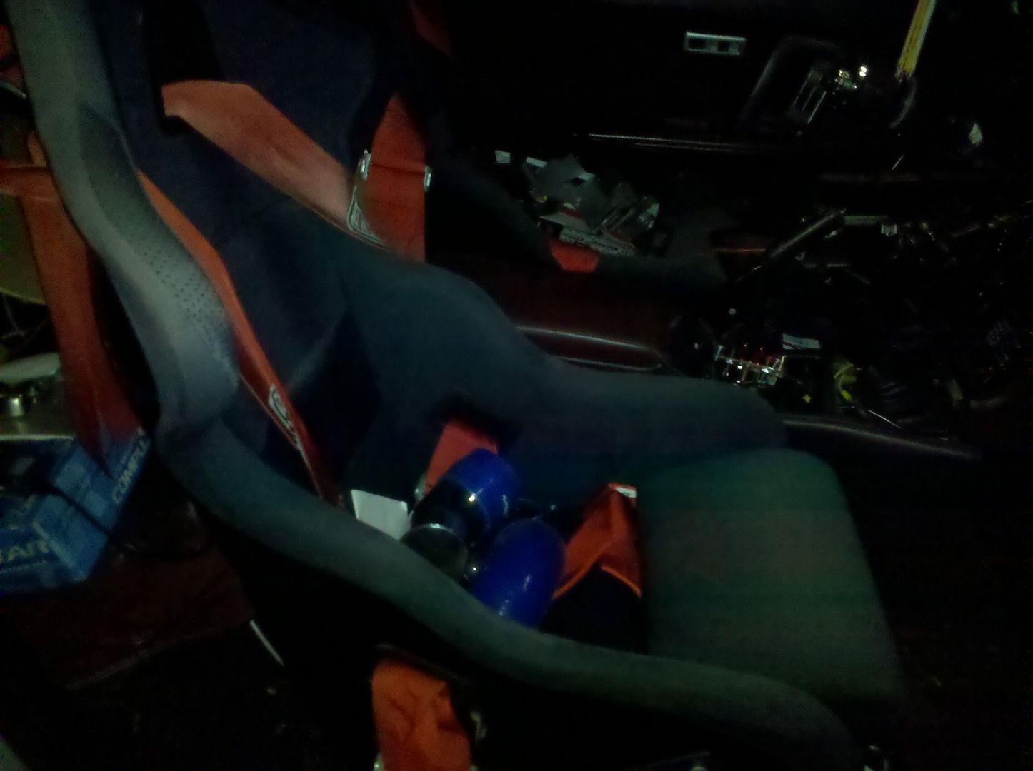

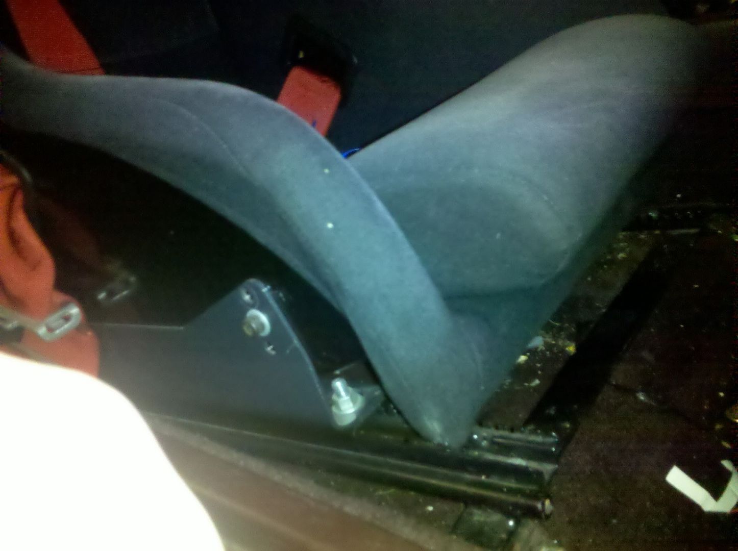

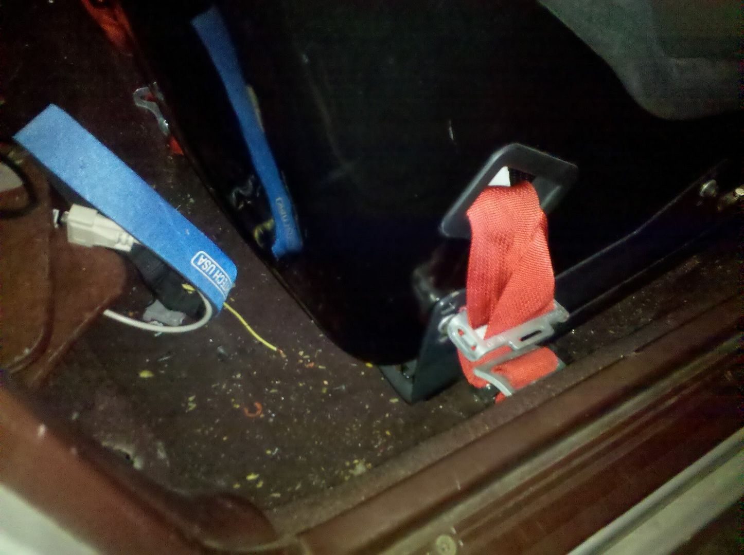

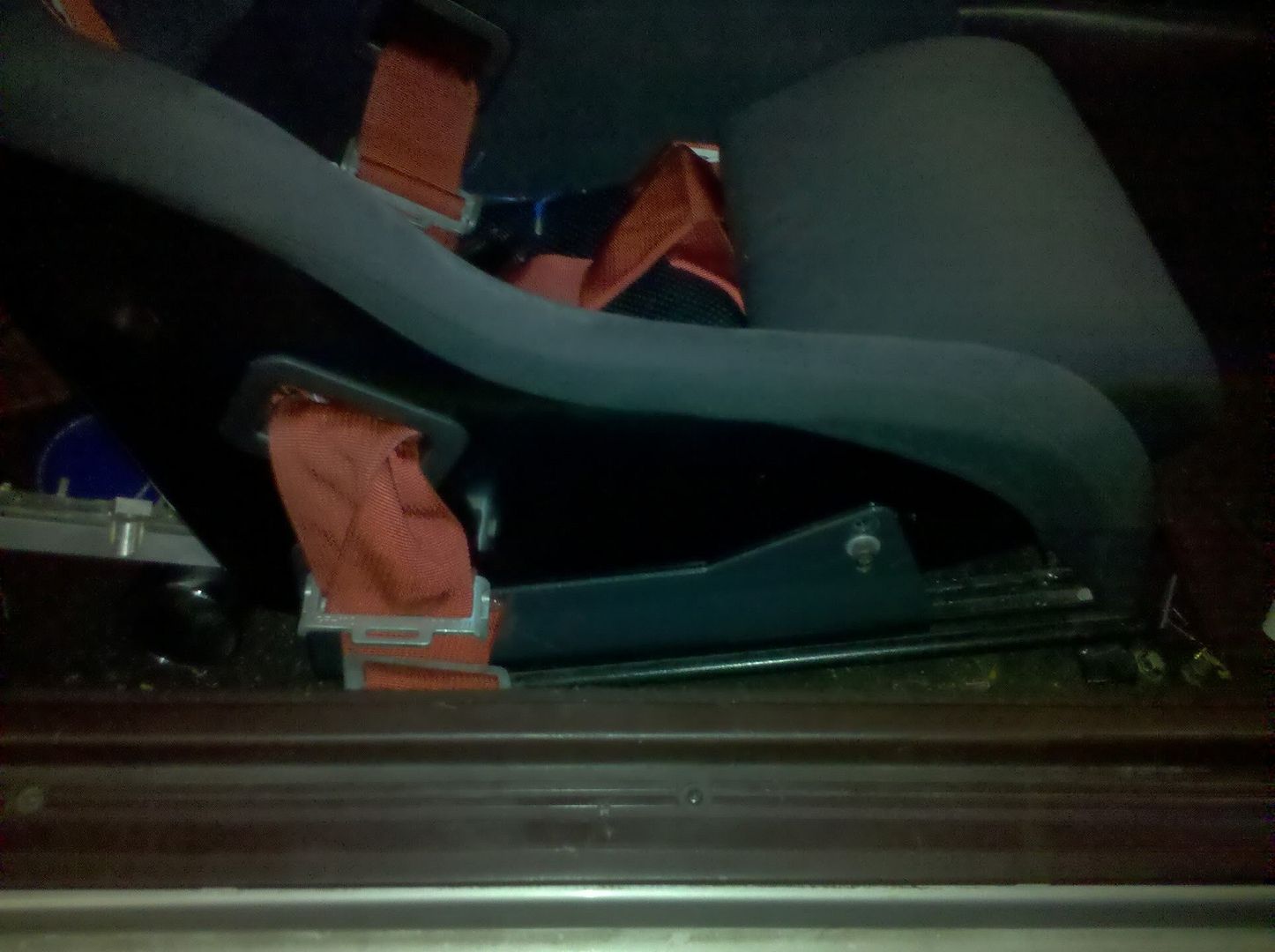

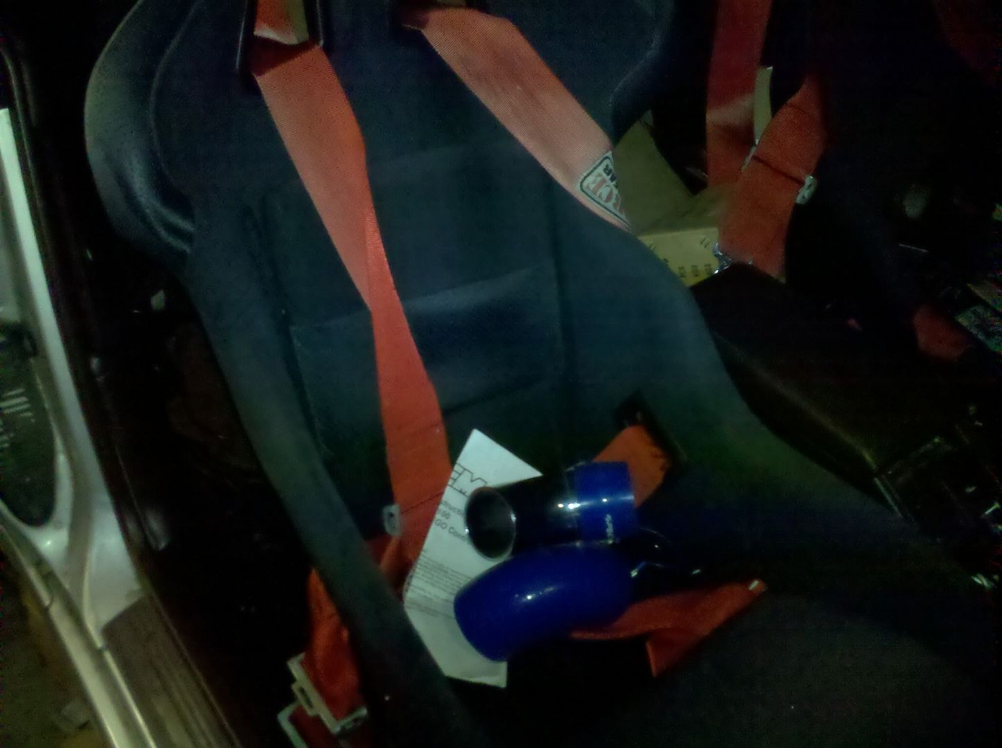

RPSil13;1707437 said:
@northwest, can you post a pic of your seats, im having an issue w/ mine sitting to high
thanks
ill try to go and grab some here in a bit

i know the importance of the roll cage, im thankful your posting your thoughts and opions that is what this site is good, for. Also its a dune buggy not a go cart
this is a similar design to what his looks like in case you were curious what a real mans go kart looks like
i asked him to come over yesterday and take a look at some stuff that i was doing and he tought me some new stuff when it came to fabricating brackets and my mind got blown, idk what this guys history is but i know he deffinatly knows more about fabricating than i do, and i know he knows alot more about making a exo cage than i do. And i know that his welder isnt just you $75 welder from your local parts store, its a big boy welder. But now instead of sitting here all day and telling me how my guy probably isnt good enough to make a cage maybe you could be like Van and give me a website to look at, maybe a place to call and get a quote. Because without having other options i'll just have a dead end and a car with no cage because my friend across the street obviously cant be good enough, hell idk he could have been a fabricator for a living or an engineer, i'll ask him next time i see him, if not i know engineers, and i know a couple of very good fabricators. If i need to get them and put them in one room ill do it. I'll even drop their notes on here for you guys to see them so the next guy like who comes on and needs help with it will have the information. :)
