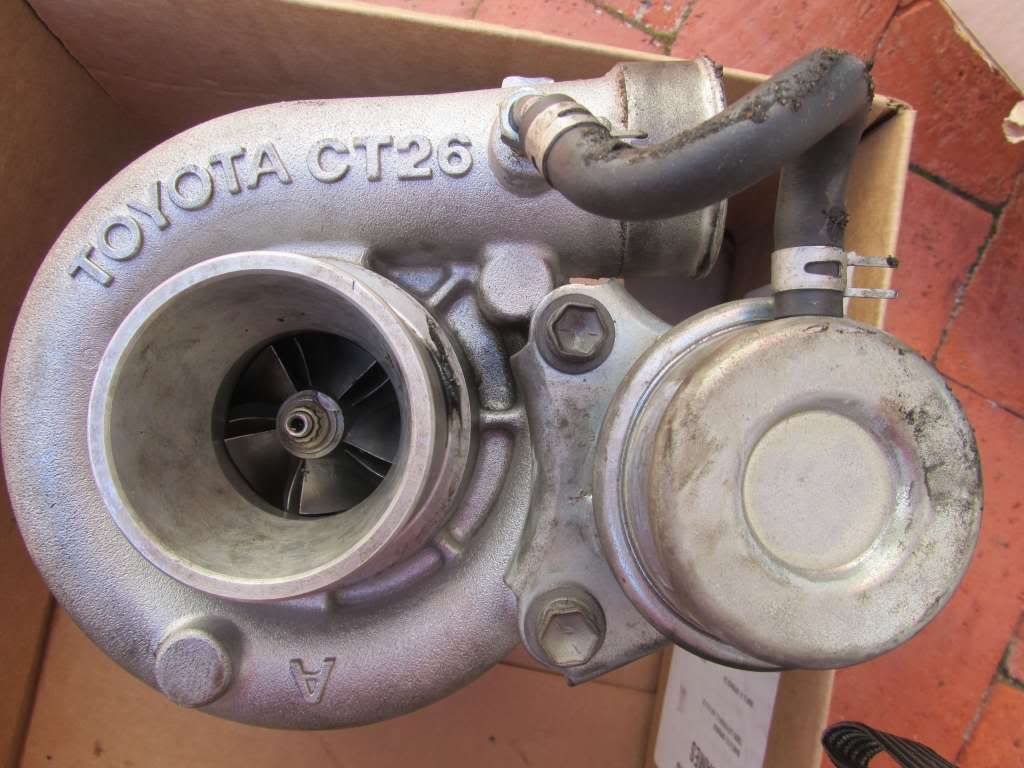

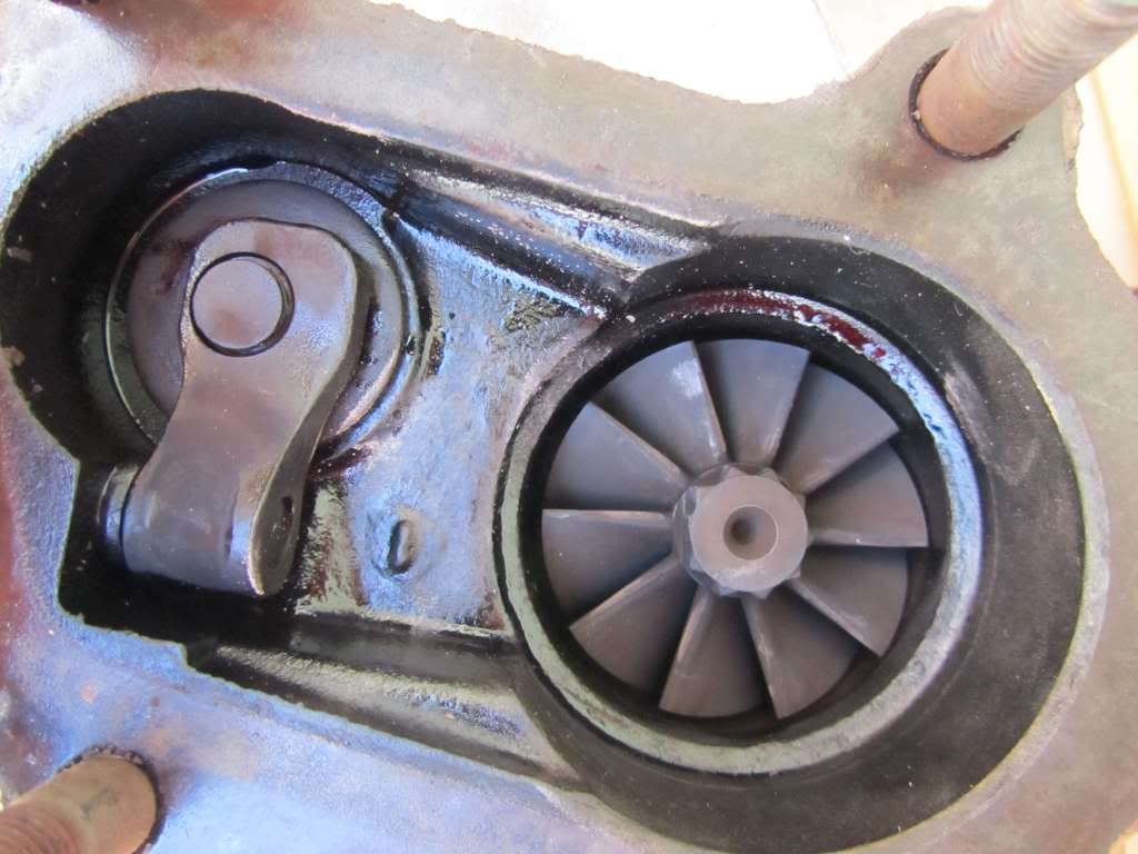

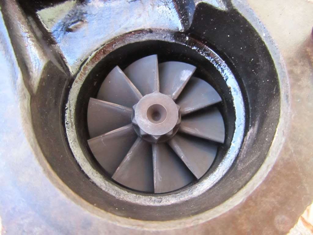

I sent the turbo off to Albert for a 57 trim upgrade.
The shaft seemed pretty loose to me. Here are some pics of it.

nice! but i really recomend the oil softline kit for re-install if you can afford them. casue after 20+ years, just worth the investment to avoid leaks

Poodles;1814811 said:
That's actually one of the cleanest CT's I've seen. Usually the compressor wheel is nicked all to hell.
Yea, I'm impressed too.
