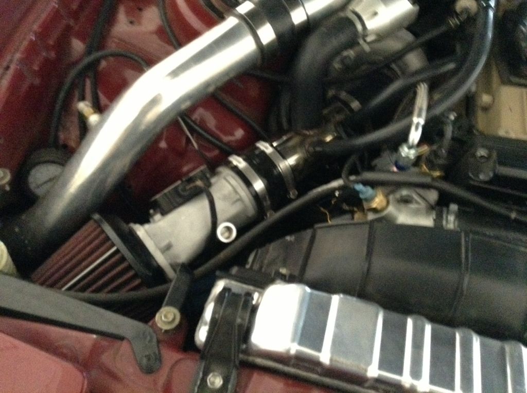

My setup with a custom "accordion" pipe
Very nice, I bet it works great with the larger fitting. Is that 3" pipe? What did you do for a power steering reservoir?
CyFi6
Aliens.
Oct 11, 2007
2,972
Phoenix
www.google.com
Yeah its a 3" pipe, the inlet on the CT26 is slightly smaller than 3" but I was able to tighten the clamp enough to make it seal on it fine. This car was originally NA non ABS so I had moved the NA reservoir back where the ABS would be a long time ago, but ya it would probably be a problem in the stock 7mgte location. The recirc works great, no surge or anything. Only problem I have is that it sometimes hesitates when I partially let off the throttle after accelerating, it might be the turbulence right near the airflow sensor, but it could be totally unrelated. My suggestion is put the recirc fitting as far away from the airflow sensor as possible.
